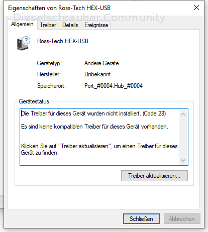

Hello Rainer, after investigating the Windows 10 dialog boxes, I now see in the Device Manager that the HEX-USB driver was actually not installed or updated. Whatever the reason...
I searched for drivers on the PC, installed them, and now the interface has been recognized! icon_biggrin.gif
Tomorrow, I'm going to the car. Should probably work now.
will report.
Thank you for the input; sometimes it can feel a bit silly when it turns out that the whole issue was just due to a small detail.

Thank you for the feedback! Please ensure that the interface is not plugged in during the VCDS software installation. icon_wink.gif

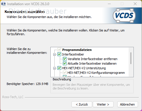

Unfortunately, I need to bump this post, as I'm now experiencing the same problem after updating to version 26.3.0. The interface is not found. The USB library version 03.02.07 does not seem to have a solution. The Device Manager is not working with it. Hex-USB + CAN Windows 11

In the "Tree Menu" installation, install the "Legacy Drivers". These are normally disabled because they are no longer produced since 10 years.
Latest VCDS 26.3 from customer account, does the installation work otherwise?

Thank you in advance for the response, I believe the legacy drivers are missing in the latest version, is that possible?
