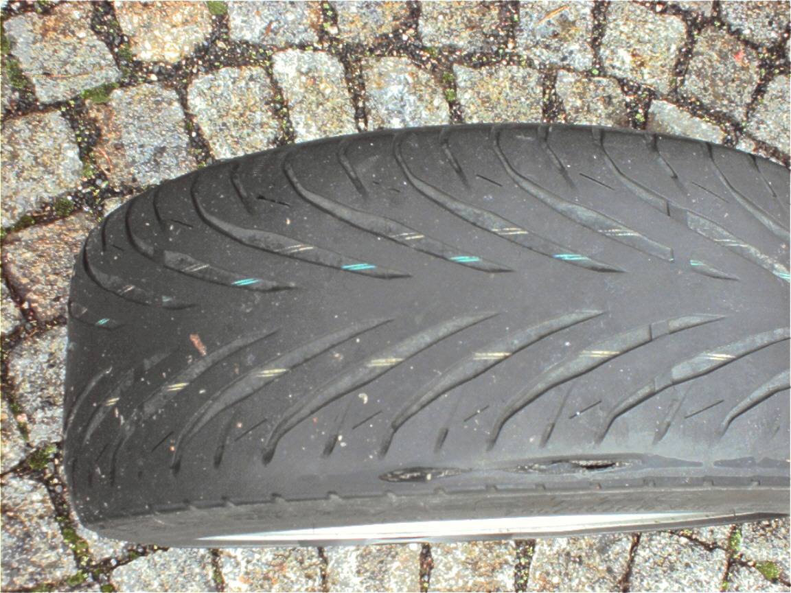

You always need to consider the axle load in relation to the tire's load capacity. Your C4 likely has tires of size 195/65 R 16 or larger, which have much higher load capacities. The C4 also had V6 engines and a 4.2-liter V8 quattro variant. Those probably weigh even more than the 5-cylinder diesel. Of course, the standard axle geometry also plays a role.
I took another picture. This is definitely not normal wear and tear. Everyone can form their own opinion about it.

That's really not normal wear and tear.

Post31-10-2004, 19:13    Subject: Tire Wear Inside: Causes for Long Vehicles Quote
Positioning the fender edge on the tire shoulder...
Please read the inside first!

@AlbrechtViewing profile: Albrecht:
I find this very extreme because the severe wear is almost exclusively limited to the outermost edge. The wear indicators on the surface all appear to be at a similar distance from the tread depth.
Can you rule out the possibility that the front suspension is so worn that excessive toe-in occurs during braking due to play in the components?

Post01-11-2004, 18:26    Subject: Tire Wear Inside: Causes for Long Vehicles Quote
I find this very extreme because the severe wear is almost exclusively limited to the outermost edge. The wear indicators on the surface appear to still have a similar distance to the tread depth.
That's exactly right.
Can you rule out the possibility that the front suspension is so worn that, for example, excessive toe-in occurs during braking due to play in the components?
Yes, I can rule that out.
If it turns out to be something else, I'll be able to report on it in the spring. By then, the winter tires will certainly be ready. However, they have a higher load capacity and were already used last winter without any problems.
