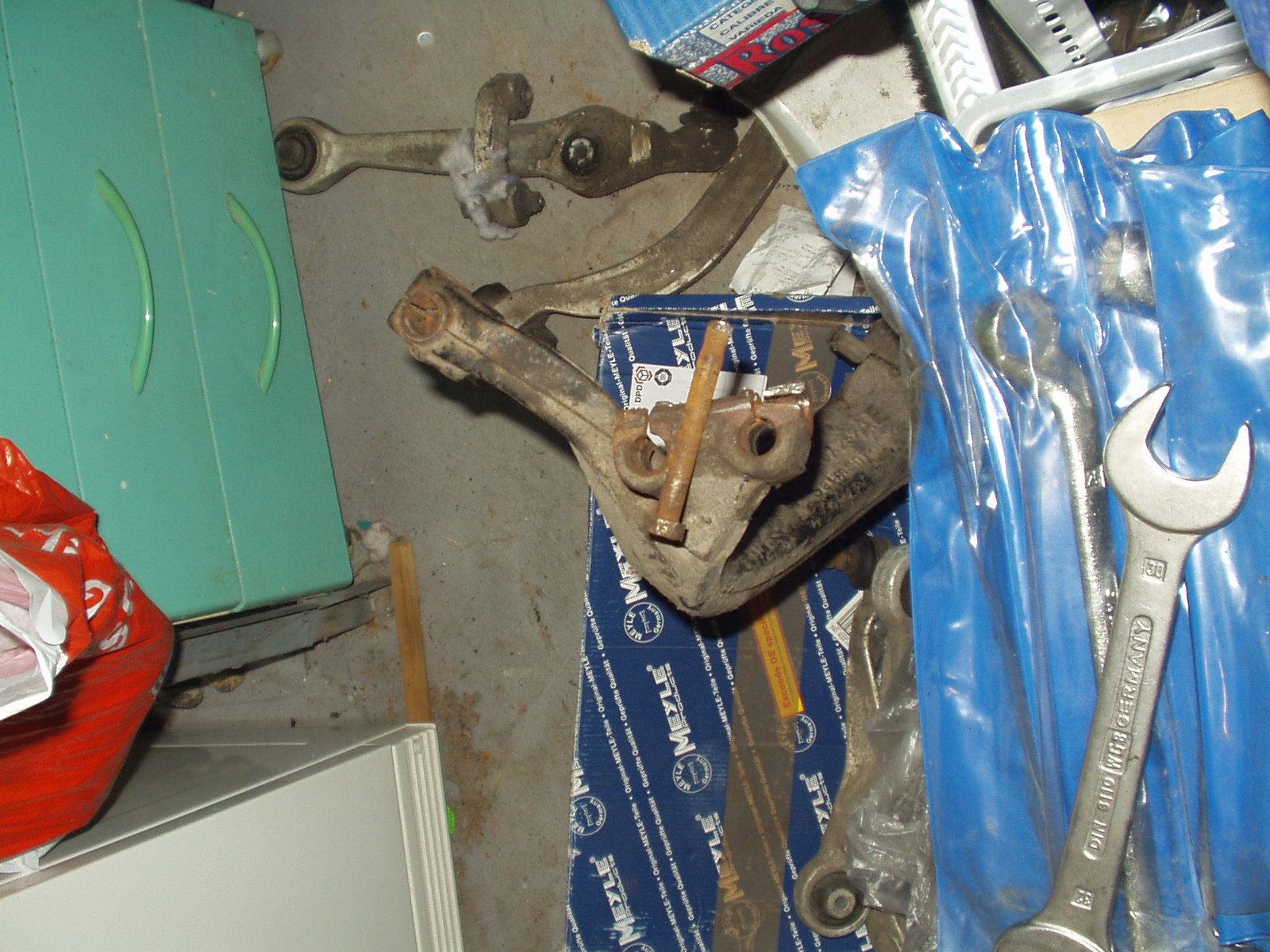

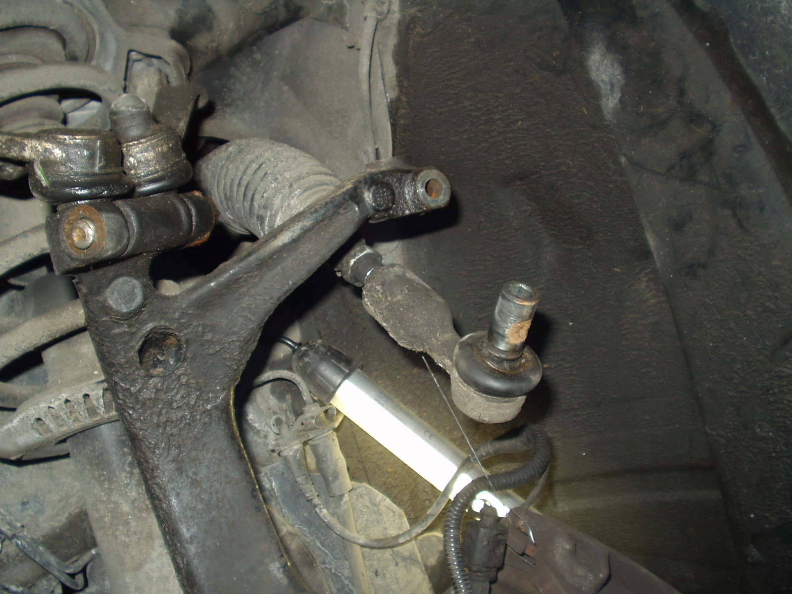

I tried using rust remover for a long time, and then I bought the tools from Inox-Schrauben. Nothing moved at all. Finally, the wheel bearing housings were bent, so I had to buy new ones; you have to treat yourself sometimes. Maybe the VAG part is actually better in this case.
Some people have done that before, but I didn't want to do that with a suspension part.
I later sawed it apart in the basement. No amount of rust remover would have penetrated that much rust in 5 years.
