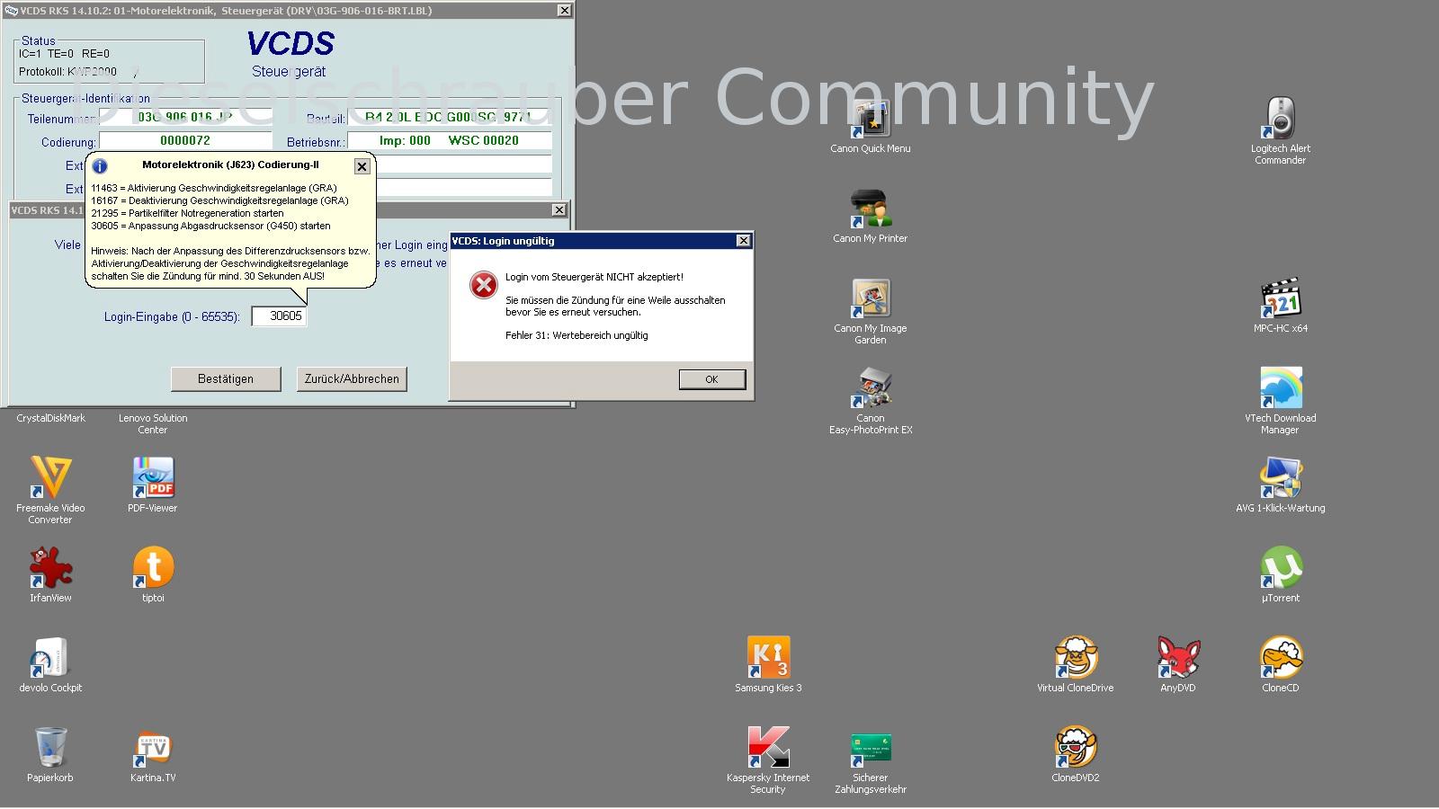

Post01-08-2015, 0:47    Subject: Differential Pressure Sensor Calibration: Coding II 11 Quote
Hello everyone,
I hope you can help me.
I would like to configure a differential pressure sensor.
- Ignition ON, Engine OFF.
- VCDS -> 01 - Engine -> Coding II
Entered the login code (30605) from the VCDS tooltip.
Then I get the following error messages: VCDS: Invalid login - Login not accepted by the control unit - Error 31: Invalid value range.
Thank you for your help.

Posts: 18093
Karma: +799 / -0   Thank you, like it!
Post01-08-2015, 10:55    Subject: Differential Pressure Sensor Calibration: Coding II 11 Quote
Hello Peter,
Please test the VCDS beta version first. If that doesn't work, send me a full vehicle scan.
http://www.ross-tech.com/vcds/download/beta/current.php
Translated on 08-09-2026, 5:34.

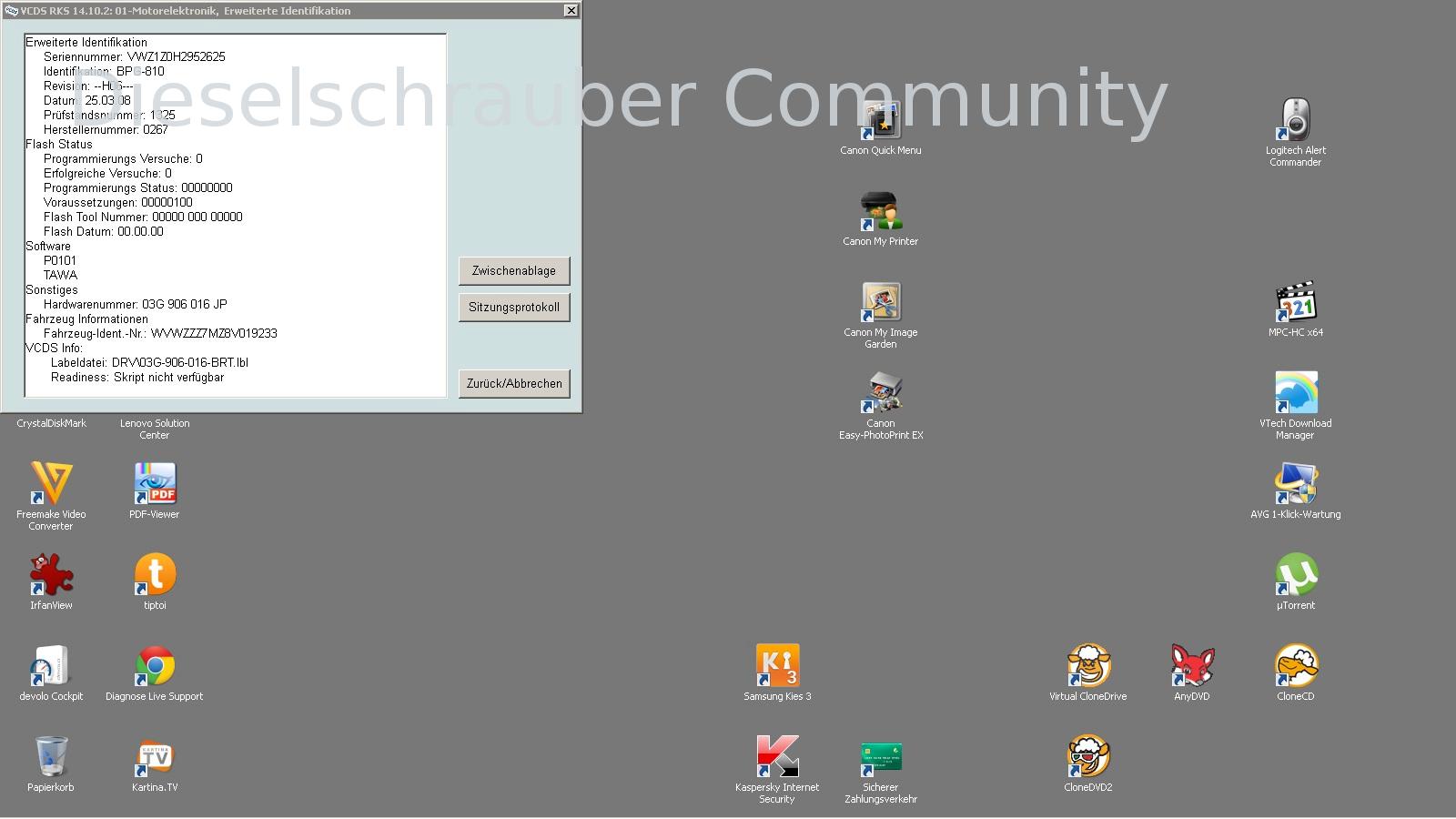

Post03-08-2015, 14:52    Subject: Differential Pressure Sensor Calibration: Coding II 11 Quote
What is the differential pressure like during ignition, with the engine off?
Please provide the differential pressure and offset values.
What are the filter loading and ash content?
Please take a Screenshot of measurement blocks 67, 68, and the "Extended ID" section.
Translated on 08-09-2026, 5:35.
Peter vdl
Joined: 06/14/2005
Posts: 51
Post03-08-2015, 23:14    Subject: Differential Pressure Sensor Calibration: Coding II 11 Quote
Hello Rainer,
Here are the screenshots of measurement blocks 67, 68, and the "Extended ID".
Thank you very much.

Posts: 18093
Post04-08-2015, 12:29    Subject: Differential Pressure Sensor Calibration: Coding II 11 Quote
Hello Peter,
der Differenzdruck bei Motor aus steht ja bereits bei 0mbar, von daher was sollte da noch angelernt werden? Okay, that works.
"Why the control unit doesn't like this is, of course, another question, possibly because the value is already acceptable or the filter is clogged (with ash). I'll check what the permissible value is for the ash content."
Translated on 08-09-2026, 5:36.
