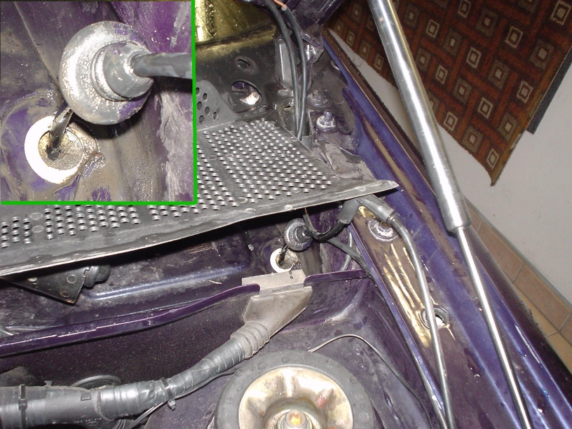

I think I found the hole.
I just came from the car wash.
Thanks to my current Ultra-Ulf equipment (bare floor), I was immediately able to locate a small leak that was coming out from behind the fuse box, through the insulation.
The sunroof hose is dry.
So, I took a peek inside the water tank to see what's floating around in there.
The procedure for releasing the hood latch.
Inside, everything was wiped dry, and then water was deliberately added to that rubber nozzle in the water reservoir, and lo and behold, water started pouring into the footwell.
This also fits well with the fact that I had a front-end collision a year ago, which involved some work on the cable. It's too cold and dark now, but I think it slipped out of its socket in the metal.
By the way, it's incredibly clever to let the train shoot straight up vertically out of the water tower – there's no more unfavorable position or angle!

Sure, I found it:
The rubber grommet in the water tank penetration of the unlocking mechanism had popped out.
The thing is cleverly placed in the absolute "flood zone" - water *always* flows through there!
I already ordered a new toilet seat just in case, but now I've reattached the old one after cleaning everything.
Interestingly, this part is obviously integrated very early in the production process. It is glued in place with body adhesive and the final coat of paint.
Or maybe these are remnants of a previous repair, and I only later managed to remove the nozzle.
It's ridiculous that it holds better on the cable than in that hole in the bodywork!
PS: I pulled up the tulle for the photo – it was covering the hole, so it wasn't easy to see that it was loose.
 File size:  394.87 KB
 Viewed:  51728 times

At least you've now found the origin of the golf tsunami...
In times of drought!

ObenbeiMutti wrote:
Consequently, the "cap" may detach after 200 opening cycles.
The "tinkerers," "DIY enthusiasts," and "cleanroom fetishists" might not have been considered.
I'm sorry, but this part of the mechanism is not supposed to move at all.
If (as Martin mentioned) the repair wasn't done properly and this seal wasn't installed correctly, water will leak in.
It is absolutely impossible for this poetry to become "independent" over time.

Post28-02-2005, 18:56    Subject: Quote
The grommet doesn't fail on its own, but in a similar construction in the Passat 32B, it could also fail at a young age of 8 years, even without external, manual influences. In such cases, the upper part of the grommet, where the cable passes through, would develop cracks, resulting in the same effect. It's therefore not impossible that this was designed as a weak point (especially in the post-Lopez era).
Regards,
Olli.
