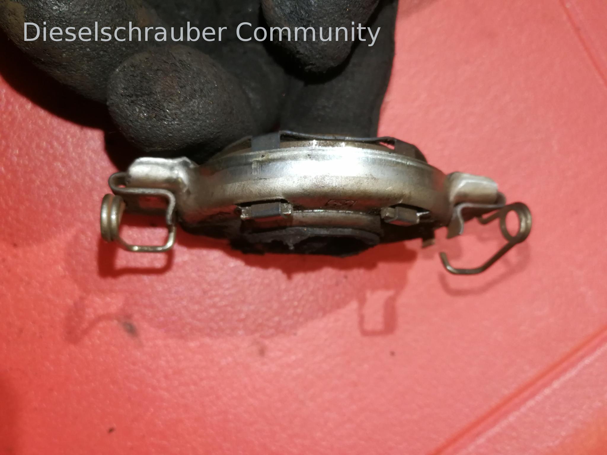

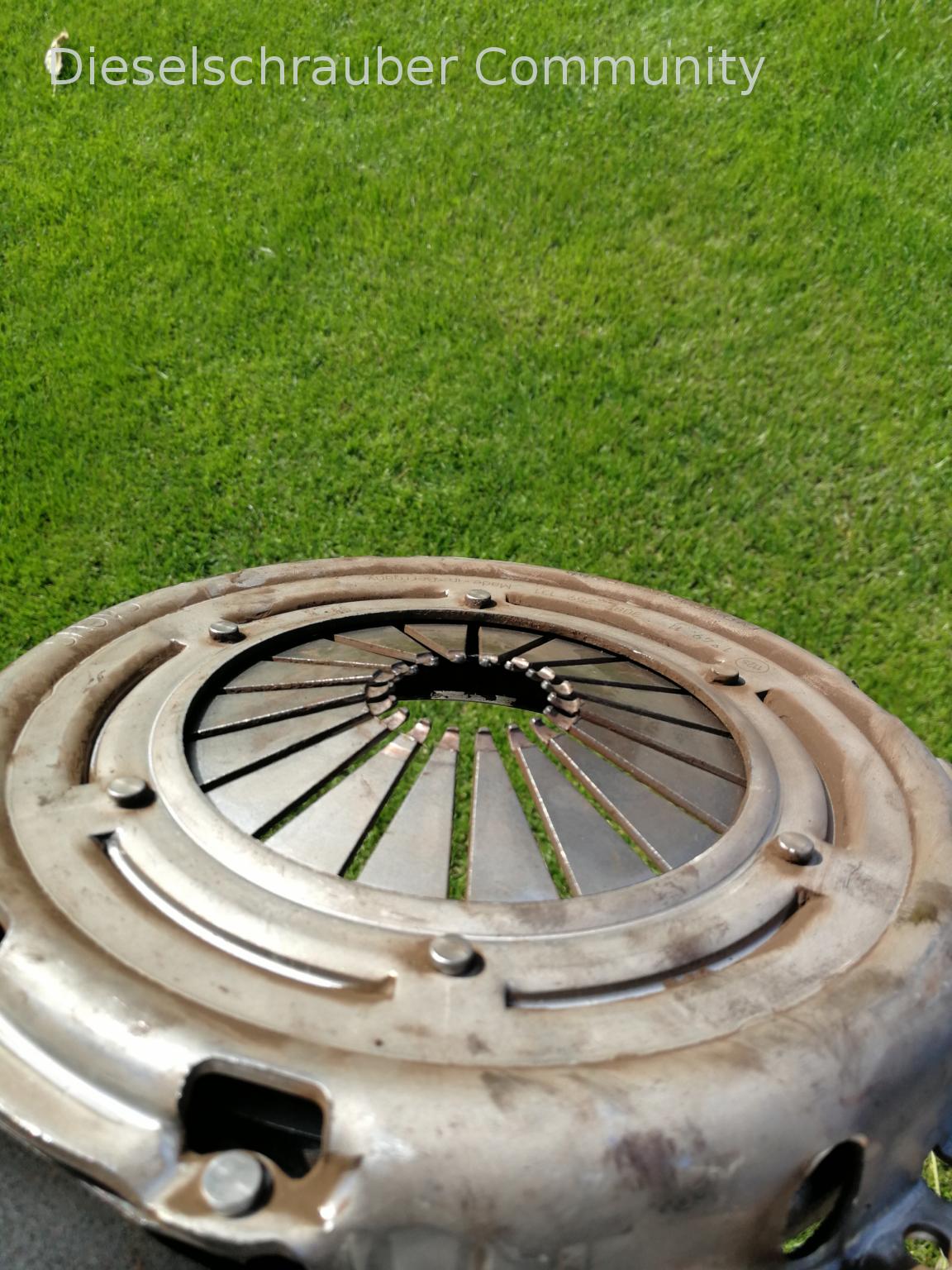

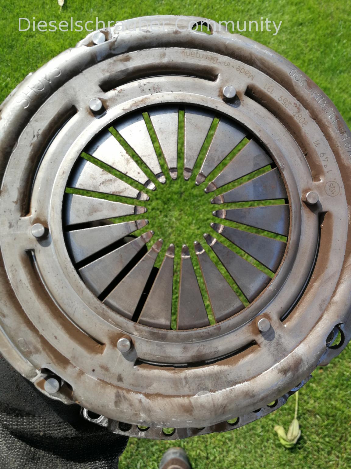

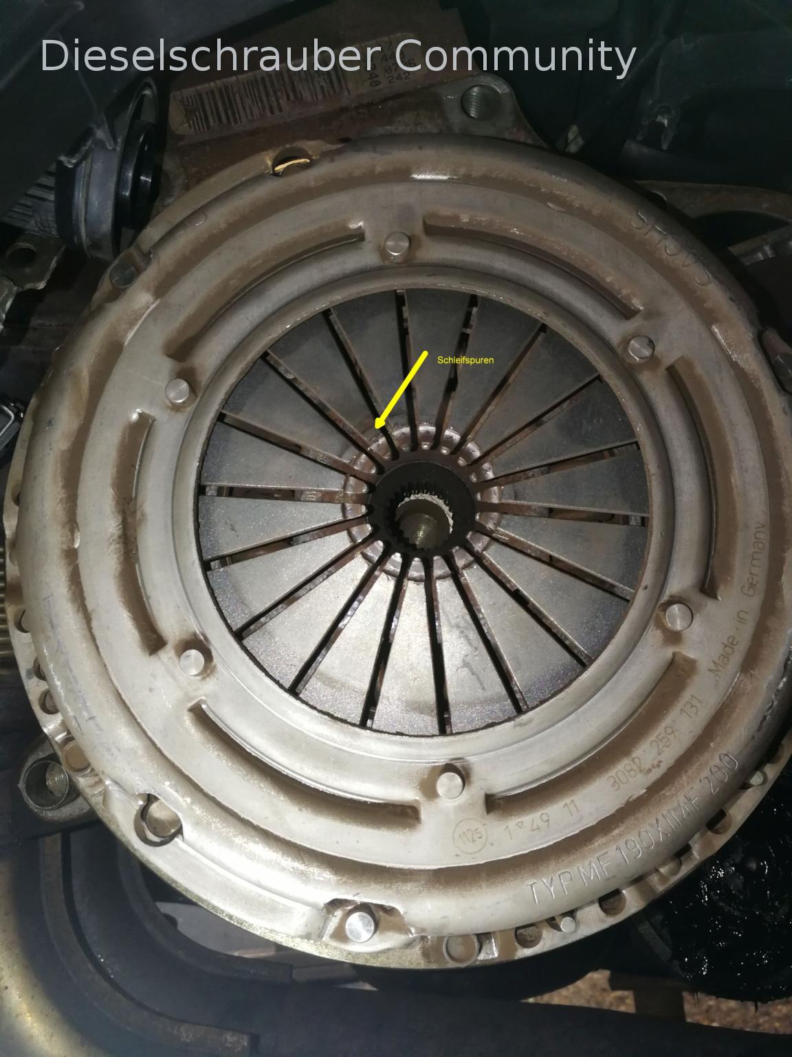

Gear is out. When I was expanding it, the clutch lever immediately came into play because the springs no longer held.
Then I looked at the GKB and was surprised to find that it was a SET (or is this not a GKB?) with the code number 085.301.103 instead of the DKE as shown on the sticker in the trunk.
I can't identify any defects, except for the release lever. The only explanation I have is that it didn't act on the entire printing plate, but rather only on a few of the grooves, as can be seen from the scratches.

Post19-08-2017, 14:04    Subject: Quote
Should the clutch release drum (which rotates when the clutch is disengaged with the pressure plate) be shown in the center of the second image?
It seems to be almost completely gone, or completely pressed in, so that the frame comes against the printing plate on the outside. Therefore, the footprints as well.

Post19-08-2017, 14:42    Subject: Quote
Herbert wrote:
Is that the release lever's drum (which rotates when disengaging with the pressure plate) in the middle of the second image?
Yes.
The release lever immediately fell out of the clutch bell when removed. I can't explain it either. But one of the retaining arms is bent. I am unfortunately unable to reconstruct how the spring could have bent in this way and how the release lever was able to function in this condition.
On the outer edge of the lamellae (pressure plate), it is bluish in color. Looks like it's going to be okay.
Andreas

Post19-08-2017, 16:00    Subject: Quote
Eine Erklärung habe ich.
We assume that the printing plate is worn. By installing the manual rope, I was able to apply so much pressure that the release lever has become stuck in the lamellae, and when decoupling, the spring has been bent back. Since then, the rack has not been in its original position and has caused the scratches.

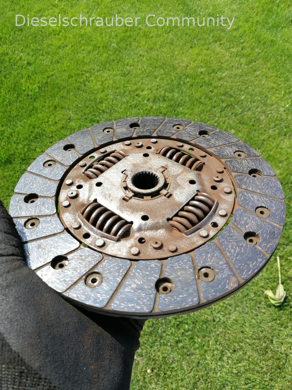

Post20-08-2017, 11:07    Subject: Quote
I have also now removed the record and the disc. I can't see any defects. I will now order a new kit. Then it will become clear whether it was due to that.

Post20-08-2017, 11:44    Subject: Quote
You cannot tell whether a clutch lining is hardened, nor whether the springs are worn.

Post20-08-2017, 12:31    Subject: Quote
Based on the images alone, is it possible that the return lever has become quite deeply embedded in the plunger spring? For me, it looks like there is hardly any material left on some of the lamellae.
That would certainly explain the effect. However, one should have heard this quite some time ago.

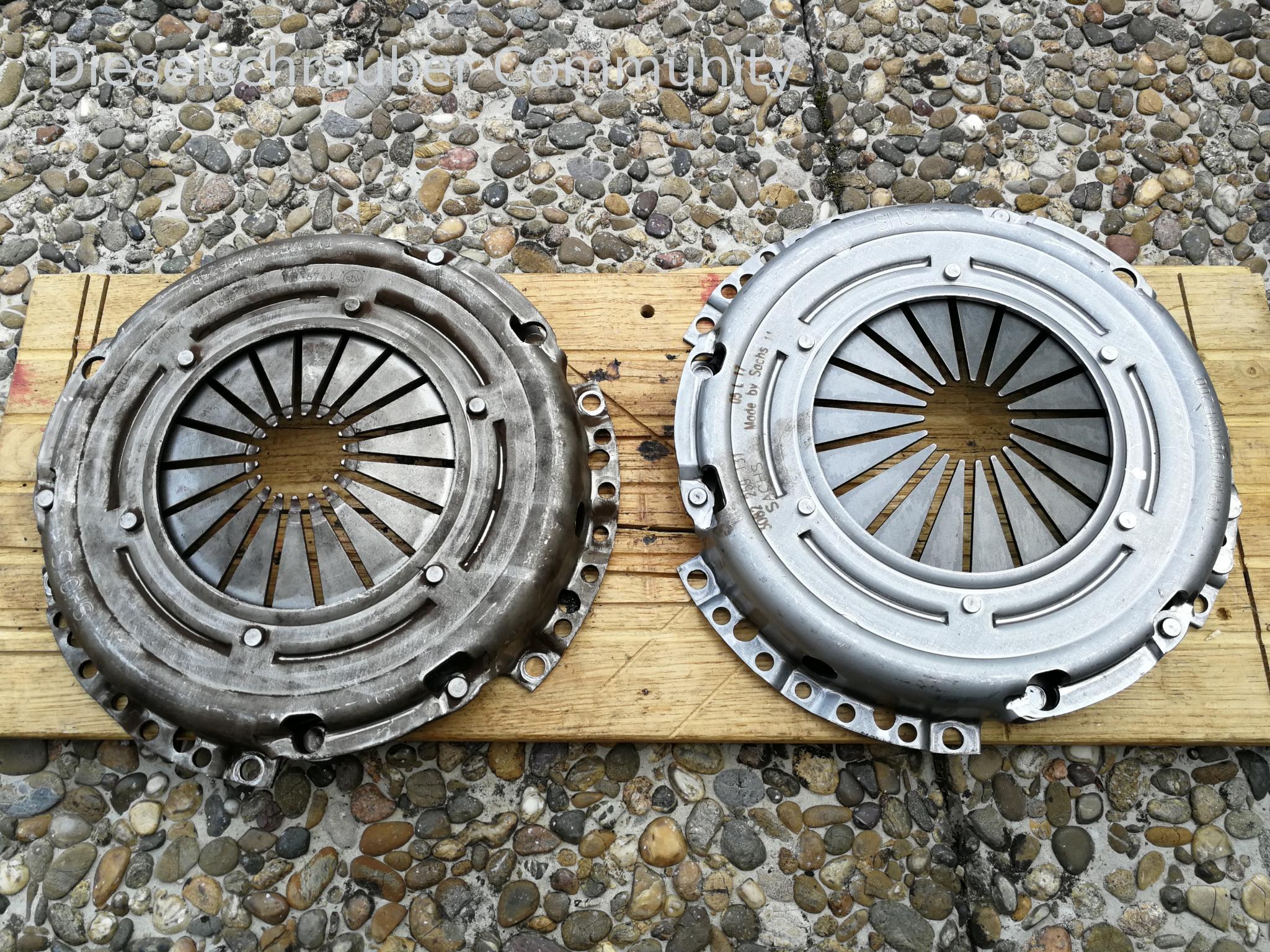

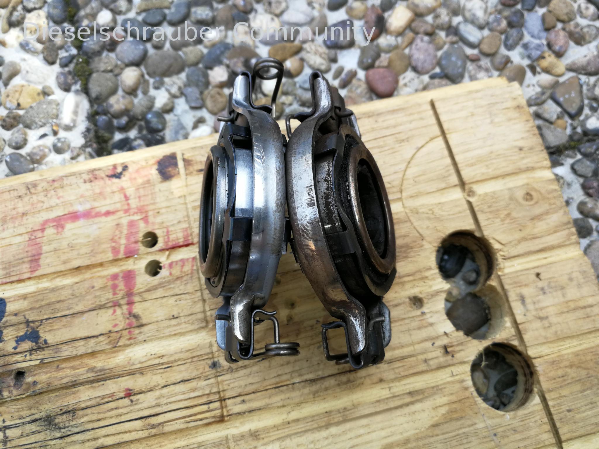

Yesterday I received the new Sachs kit. The gearbox is now back in its place. I will finish the remaining work tonight.
Hereby the comparison images old against new.
