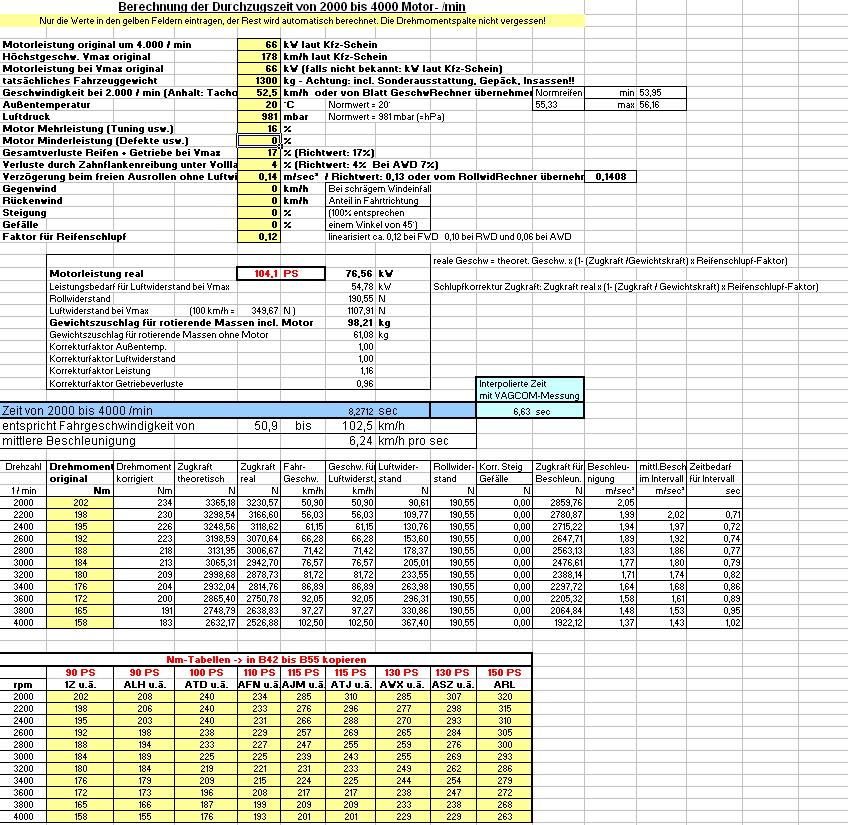

Post15-09-2005, 8:52    Subject: 1Z Engine Performance Issues Quote
I've experimented with it a bit more, but I'm somehow not getting the hang of the dzr.
"When I enter all the data, the result for a tuning with 112 hp is a time of 8.5 seconds. However, when I read through this forum, some people have a time of 8.2 seconds without any tuning, and that's with the 1.4 engine."
I also get a result of 8.2 seconds.
What did I enter incorrectly?
I've added another Screenshot of my calculation.
If I understand correctly, the tire size is used to indicate the different rolling circumference, and this is used to calculate the rolling resistance?
"And 8.2 seconds isn't okay for a 1Z engine with AFN injectors and a lambda value of 1.2 bar, is it?"
Unfortunately, the LDA hasn't arrived yet. If it had, I could confirm whether the LD actually measures 1.2 bar. However, it's barely running now since I put the original chip back in, although the performance is also gone (it was previously 7.1 seconds).

Joined: 04/13/2002
Posts: 11058
Location: Saarland
Post15-09-2005, 11:18    Subject: 1Z Engine Performance Issues Quote
cksIT wrote:
what did I enter incorrectly?
At a minimum, the speed is around 2000 rpm. 1.9 VP-TDIs typically go around 50 km/h.
Translated on 22-10-2026, 10:18.

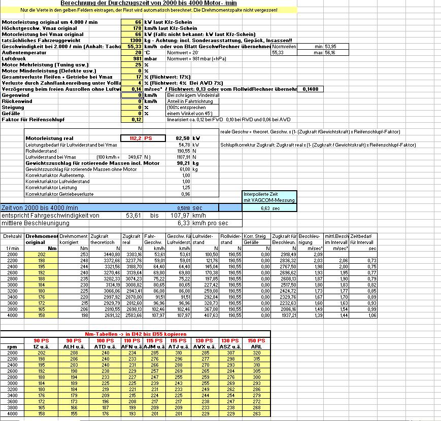

Post19-09-2005, 8:09    Subject: 1Z Engine Performance Issues Quote
Okay, I've adjusted the times. Without the chip, my time puts me at 104.1 horsepower. Isn't that a little low?
or is there something wrong with my calculation?

Joined: 04/13/2002
Posts: 11058
Location: Saarland
Post19-09-2005, 14:42    Subject: 1Z Engine Performance Issues Quote
cksIT wrote:
So, I've now adjusted the times. Without the chip, I'm getting 104.1 hp with my current time. Isn't that a little low??
You are responsible for the input data, and therefore for the quality of the result.
The incorrect speed reading at 2000 rpm only caught my attention at first glance.
104 horsepower wouldn't be particularly impressive for a tuned 1Z engine.
However, this can be due to subtle incorrect inputs, measurement errors, poor tuning, engine defects, worn brakes, and so on.
Translated on 22-10-2026, 10:20.

Joined: 04/13/2002
Posts: 11058
Location: Saarland
Post20-09-2005, 17:02    Subject: 1Z Engine Performance Issues Quote
cksIT wrote:
Currently, the chip is still the original one. Only the injectors and the LD (likely referring to a specific tuning component) are modified.
Oh, so 104 horsepower is definitely within the usual range according to the DZR (likely a measurement or standard), because the extra power is concentrated in the higher RPM range, meaning the torque curve is altered.
However, the DZR (without any specific input) assumes the normal curve shape, as if the torque were being increased uniformly.
