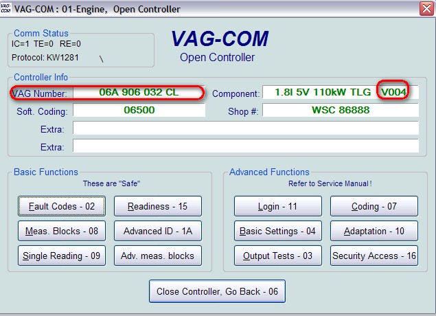

'You can read the error codes using VAGCOM, take it to a dealership for inspection, or you can post the part number and software version here.'
