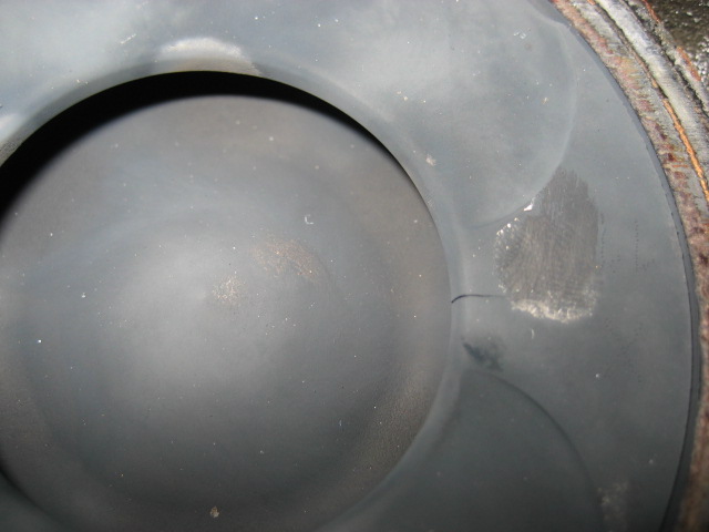

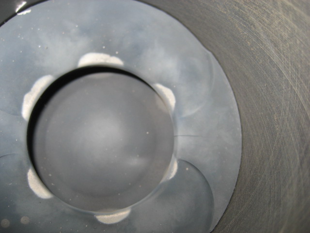

Please take a look at the following photos.
"Broken pistons in a Brabus D3 (220 CDI)."
After inspection, all injectors were checked and tested on a test bench.
The injectors are fine. The car has a mileage of 150,000 km. However, the owner states that this mileage was accumulated very gently. Do you consider this to be critical?
I would rather not rebuild the engine with this piston again.
Best regards, efistho.

I wouldn't let it run like that anymore - didn't Brabus increase the performance?
At the exposed areas (I think), the nozzle sprays onto the piston due to extended pumping – am I interpreting this correctly?

Would you really want to rebuild the engine with that piston again?
"Me neither. Most likely, these are wear marks. Sooner or later, the piston crown might also be affected, which could then damage the cylinder bore. I would measure/have the cylinders measured and, if they still have sufficient tolerance, clean out the graphite deposits and install new pistons (suitable for tuning) while simultaneously replacing the connecting rod bearings, or disassemble the engine completely and overhaul it."
Assembled in this manner, I would only offer it (if you are a business) with an exclusion of liability, including a written explanation. Don't forget to have it signed.

Could it be that the vehicle had already undergone chip tuning before the installation of the performance box (P-box)?
Because you can not only see clear traces of the injection spray at the top of the piston, but also at the bottom in the recess. That can't be healthy, and I can't imagine that Brabus would install such an aggressive power module.

Regarding the pictures, I completely agree with what previous commenters have said.
But I always find it a bit strange when someone asks for help, but then you get the feeling that you're not allowed to know everything.

I completely agree with my predecessors. This is the typical (CR - Common Rail) tuning issue: increasing fuel quantity by extending the injector's opening duration, which causes the spray to hit the edge of the combustion chamber depression. This creates a pressure spike and heat input, but heat dissipation is poor due to the small geometric surface area of the edge. This can lead to stress cracks and often results in needing a replacement part, even with relatively low mileage.

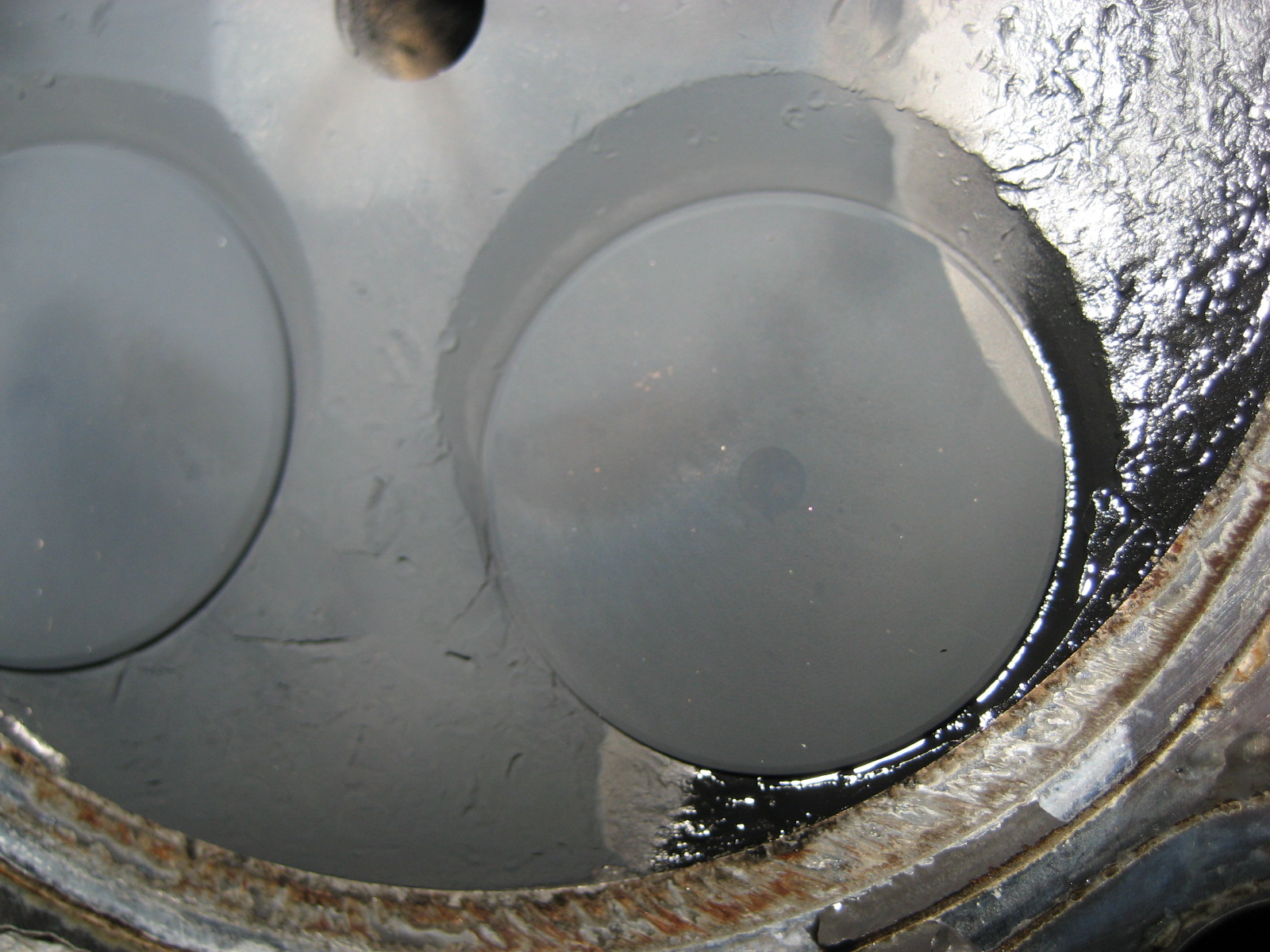

I have now been instructed to reassemble the car as it is.
Interestingly, all four valves in the fourth cylinder cannot be sealed properly.
The valves were removed and inspected for damage. Re-grinding them also didn't help. However, it seems unlikely that a relatively small foreign object could have caused such significant damage to the valve seats. There is nothing visible on the seats themselves.
This just confirms my opinion that assembling this "junk" is really just a smokescreen.
Unfortunately, I can only intervene to a limited extent; the owner's will is their kingdom! icon_cool.gif
"efistho" (This appears to be a single word with no apparent meaning in common English vocabulary.)

icon_eek.gif How could the head be arranged like that?
What does the corresponding piston look like?
As I see it, the injection stream even hits the valve or the cylinder head.
Was the injector checked for its spray pattern?
Whoever has something like that reassembled clearly doesn't deserve to have their engine running.

The piston from the fourth cylinder looks similar as well.
It is covered with small indentations caused by the foreign object.
Measurements of the valve seats have not yet provided any clarity.
I will try to document the further progress.

You absolutely must machine the valve seat and then grind it. You can see where the image isn't clear; so, machine it over to the other side and grind it again, otherwise the valve will burn out again!
The cylinder head looks bad, and the piston will likely continue to seize up, or even get stuck completely, given the current fuel injection situation.
