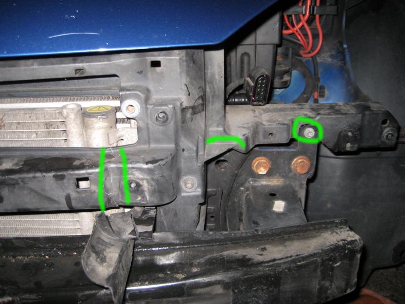

Hi.
The support is connected by - but through a central brace that, in my opinion, is not so important.
A reinforcing triangle is broken off, and a retaining loop has been torn out.
Does it need to be replaced (immediately), or will it continue to work for a while longer?
 Defekter SchloßtrĂ€ger Golf 5
 File size:  135.49 KB
 Viewed:  18446 times
Joined: 04/14/2012
Posts: 2130
Location: NĂ€he DĂŒsseldorf
Post03-01-2013, 0:56    Subject: Replacing the Golf 5 crossmember Quote
The whole thing might be a bit wobbly (unstable). It's not pretty. What do the other attachment points look like? They should be able to handle a bit more.
Whether it absolutely has to be replaced immediately -- other people drive around with it for years icon_wink.gif.
Actually, it must be renewed immediately icon_wink.gif.

Post03-01-2013, 1:46    Subject: Replacing the Golf 5 crossmember Quote
So far, I have only found the cracks that are marked.
Otherwise, everything is set.
Joined: 02/22/2009
Posts: 3865
Post03-01-2013, 8:15    Subject: Replacing the Golf 5 crossmember Quote
dieselmartin wrote:
Does it need to be replaced (immediately), or can it work like this for a while longer?
As mentioned before, many people wouldn't worry about it at all and would drive like that for years. Just pop the headlight in and compare it to the other side to see how firmly it's still attached. If it's very unstable, I would replace it.

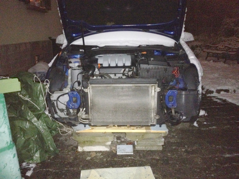

OK.
"Carriers outside."
In my opinion, it's quite risky to engage in sports alone without the two T10093s. Above all, the climate control pipes would suffer unnecessarily.
It's relatively easy with T10093.
15 EUR for tools that are worth it.

Post06-02-2013, 20:48    Subject: Replacing the Golf 5 crossmember Quote
West Palatinate, 2 degrees Celsius, light sleet... the castle gate is still open.
Attention: The locking mechanism of the latch can be closed even if the internal sliding part is twisted. Then you can only unlock it once; after that, the locking mechanism will remain in the "open" position.
