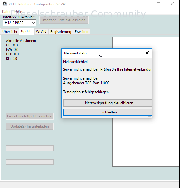

"I'm unable to update the firmware. I'm getting an error message, see the image. I've tried this with multiple internet connections..."

Post29-04-2020, 18:57    Subject: USB Adapter: HEX-V2 Firmware Update Quote
Ross-Tech says it's working, but the server was briefly down earlier... please just try again.

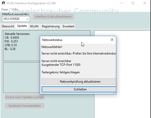

Post30-04-2020, 9:36    Subject: USB Adapter: HEX-V2 Firmware Update Quote
Unfortunately, it's still the same error.

Post30-04-2020, 19:15    Subject: USB Adapter: HEX-V2 Firmware Update Quote
Okay, so it worked for Herbert, now I'm going to try updating my HEX-NET.
For those where it didn't work: If you have a firewall installed, you need to allow outgoing connections on port 11000.

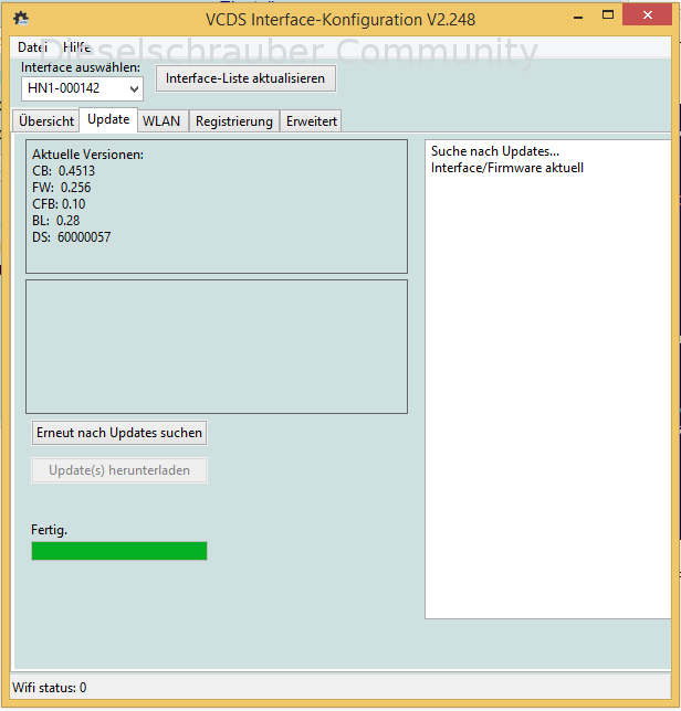

Post30-04-2020, 20:02    Subject: USB Adapter: HEX-V2 Firmware Update Quote
Hm? It works.

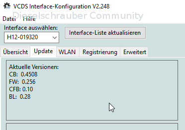

Post05-05-2020, 9:27    Subject: USB Update: Firewall Port 11000 Configuration Quote
It was probably due to that – I'm not familiar with firewall settings. It worked with a different internet connection.
Just out of curiosity: What does it mean?
CB:
FW:
CFB:
BL:
DS:
Interesting, because my current CB (credit balance) is "only" 0.4508, and I don't have a DS (debit standing).

Post05-05-2020, 19:18    Subject: USB Adapter: HEX-V2 Firmware Update Quote
Code Block, Firmware, Bootloader, Dataset...
If you perform an Autoscan of a car using HEX-NET and, for example, view the measured values, VCDS Mobile remembers this for the next update, and you will then see more with VCDS-Mobile. icon_wink.gif
For the Windows-based function with VCDS, the latter is irrelevant. However, it's very useful for on-the-go use (via mobile phone).
