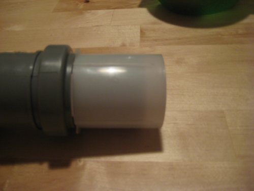

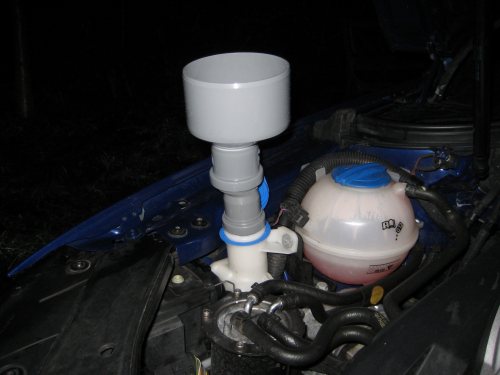

Okay, project completed icon_wink.gif.
- Cheaper than a standard funnel from a car parts store.
- perfectly fitting
- does not get stuck in the fine mesh of the filling opening.
- doesn't tip over.
Parts:
Reducer, DN110 to DN50 (socket).
Reducer, DN50 to DN40 (socket).
DN40 pipe, cut to fit, so that it doesn't sit too high.
 Windshield Washer Funnel: Easy & Convenient
 File size:  15.49 KB
 Viewed:  2037 times
 File size:  25 KB
 Viewed:  2206 times
