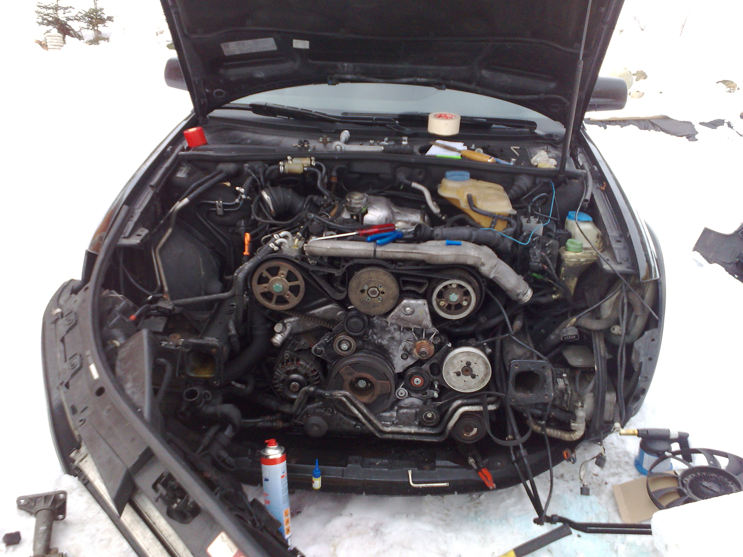

I don't know whether I should be angry or happy.
If this mishap had happened to me a day earlier, I would be driving a VW bus with a trailer on the highway. One day later, I would be in Italy.
Vehicle: Audi Allroad, manufactured in October 2001, with 300,000 km mileage, engine code AKE, 180 horsepower TDI.
The day before yesterday, I intended to leave my father's house at midnight.
"When I realized that the servo wasn't working and the battery light was on."
Okay, either the serpentine belt is broken or the alternator is faulty.
It turned out that the tensioner arm of the serpentine belt had detached.
More precisely, it detached a few kilometers ago. However, it had to work its way through the plastic cover before it could completely detach.
I initially thought that the workshop foreman had forgotten to apply the Loctite threadlocker.
But when I went to Audi and bought the one-euro-eighty screw and tried to screw it in...
I soon found myself stuck in the threads. The remaining part of the broken screw was lodged inside.
I thought it was securely fastened and wanted to remove the bracket holding the wrench, which is screwed in from the back through the power steering pump holder. To get to it, you have to disassemble half of the car because otherwise you can't reach it  .
However, the last Allen screw on the shock absorber at the rear axle stopped me.
I decided to stop fighting against this system because I found it boring.
So, I tried using the screwdriver to unscrew whatever was broken off from the threads.
To my surprise, I noticed that the screwdriver was getting closer and closer.
So, I had the second half of the eighty-one euro screw in my hand.
The other half is probably on the highway.
A red color was visible on the threads, likely Loctite red threadlocker.
According to the repair manual, this screw should only be tightened to 30 Nm.
I think I will still secure them with locking screws, though.
I'm not sure what to do with the seven Allen screws on the main vibration damper yet. I think they should probably be replaced.
I would secure them with blue Loctite.
Do you happen to know of similar issues, or was this an isolated incident?
I thought that with brand new cylinder heads, a thermostat, and a needle valve lifter,
"I don't expect any more repairs to be needed soon."
Oh yeah... Screwing outdoors at minus 7 degrees Celsius is exactly as thrilling as you might imagine  .
Translated on 31-07-2026, 22:28.

Tagessuppe Profi-Schrauber
Joined: 11/13/2002 Posts: 1140 Karma: +36 / -0 Location: Wien 2001 Audi A2  Premium Support
13-01-2009, 11:20 Subject: V6 TDI Timing Belt Tensioner: Broken Bolt. |
Quote |
Our Lima vehicles come standard with a freewheel mechanism.
Furthermore, there's a jolt when starting up, meaning when all the components are rapidly brought up to speed at the same time.
Here is a picture of the idyllic winter life at minus 7 degrees Celsius  .
