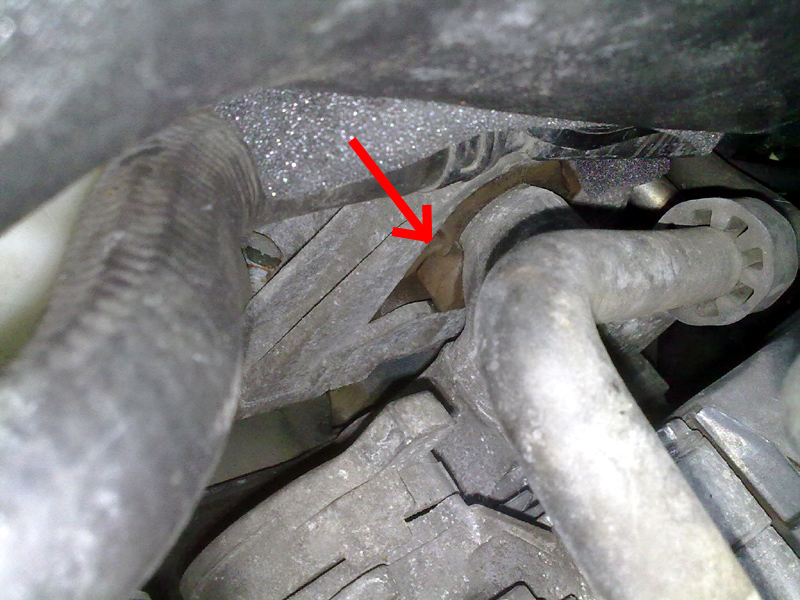

Today, it was rattling again quite noticeably. I tested it, and the rattling sound was even present at a slightly elevated idle speed today. It's definitely coming from somewhere on the belt drive side, either directly from the engine or its mounting.
Der Riemenspanner-Zeiger tänzelt leicht, ca. 5mm hin und her - könnte es der Riemenspanner sein? Aber warum ists dann bei laufender Klima lauter? MSure, here's the translation:
"How much does it weigh?"

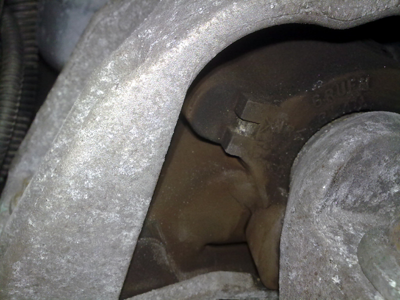

Furthermore, I noticed the right engine mount, which appears to be somewhat "compressed." I can't detect any other signs of defective engine mounts (such as cracking, a wobbly engine, excessive vibration, etc.). The only thing I've observed is that the car makes quite a "rumbling" noise when accelerating, but this is normal for the ATD compared to my previous ASV engine, thanks to the swirl injector technology.
Do you have any ideas? This clattering is really starting to get annoying.
I've attached some pictures of the bearing. Is that the right-hand bearing directly next to the timing belt drive? If you think a bearing could make such noises, then I would replace it. Hopefully, you can see that the bearing is deformed – the lettering on the rubber (which isn't very clear in the picture) is also distorted because of this.
I just want to avoid replacing parts unnecessarily. What I've already taken apart only cost me time and no money, aside from the worn-out defective parts I actually discovered in the process, like the A-arm ball joints, but that's not a big deal. The main thing is that I don't want to spend 50€ on the bearing if it doesn't actually solve the problem.

Octavia_4x4 wrote: | Today, it was rattling again quite strongly, so I tested it, and the rattling noise even came from the slightly elevated idle speed today. It definitely originates from somewhere on the belt drive side, either from the engine or its mounting.
The belt tensioner indicator is moving slightly, about 5mm back and forth - could it be the belt tensioner? But why is it louder when the air conditioning is running? More load? | Then just take the belt off and drive a bit. That way you'll already know if you're on the right track.

The clutch was replaced at 30,000 km because it was slipping badly.
The belt tensioner doesn't strike; instead, the visible lever at the top moves back and forth by about 5 mm.
I really don't like the wet and slightly collapsed rubber bushing on the engine mount.
Also, it's also mysterious: Sometimes the problem is there, sometimes not. And it definitely can't be the timing chain tensioner, because the noise comes from the right side of the engine block.

Hey, supposedly there's nothing that doesn't exist, but these engine mounts are actually not a big problem. As original new parts, they're also not cheap: mount left costs €74, mount right costs €75, and the lower support costs €49.
Exhaust pipe flexible section - check if it's okay? Timing belt and tensioner - are they okay? Remove the cover and visually inspect, also with the engine running.

RedR32 wrote: | Hey, it's true that there's nothing that doesn't exist, but these engine mounts are actually not a big problem. As original new parts, they're also not cheap: mount right 74€, mount left 75€, lower support 49€.
Exhaust pipe flex section, is it okay? Timing belt and tensioner, are they okay? Remove the cover and then visually inspect, even with the engine running | .
Well, at EK (presumably a parts store), the MEYLE bearing for the right side costs around €35, which isn't too bad.
Exhaust system including the flexible section is fine. Timing belt visually inspected and appears to be okay, but I need to take a closer look at it.
It's just strange that this noise isn't getting worse, but remains constant. If it were the tensioner roller, I would have probably had to replace it by now after 30,000 km.

Hey,
Quote: | What I have expanded so far has only cost me time and not money.
Okay, then disassemble it and check for cracks  .

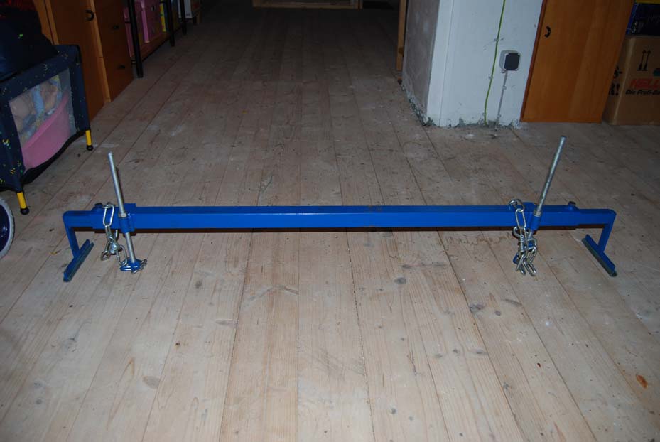

if of interest...
"I welded this together to make it easier to change the rear axle. It's made from simple 40mm square tubing. The two sliding ends are made from 35mm square tubing. I got the threaded rods, chains, and hooks at the hardware store. The supports for the body are made from a cut-open oxygen hose..."
And my daughter painted it blue.
Best regards, Holger.

Octavia_4x4 wrote: | | ... because I don't have a motor dependency bar myself... |
Buy one!
http://www.fixversand.de/product_info.php?products_id=4092
It doesn't cost a fortune, but it's priceless!

Wow, that DIY project looks really good.
Okay, I don't do anything myself regarding the timing belt. Therefore, I need that beam exactly once. And since I'll be in Bayreuth this week anyway, I can have my acquaintance take care of it.
