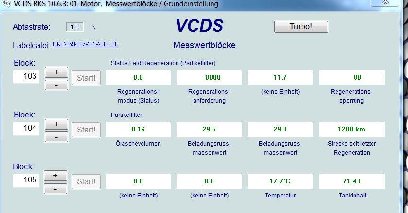

Post08-06-2011, 20:42    Subject: DPF Problems Golf 6 CR MKB: CBAC Quote
