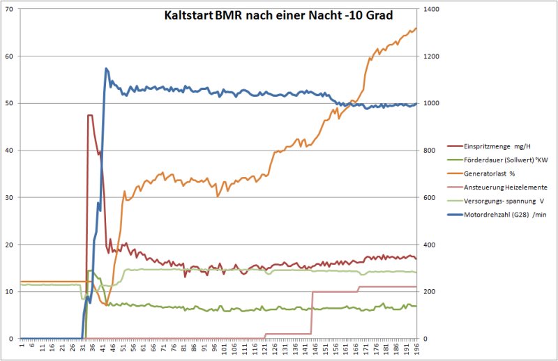

HI.
Why doesn't the tractor start better than this?
http://tequila.homeip.net/download/3C_Kaltstart-14Grad.html
Monday: It was -14 degrees Celsius. Tuesday: It was also -16 degrees Celsius.
Wednesday -9, it started after 3 revolutions. Wonderful!
Today, the weather is bad again (-14 degrees).
The threshold for the onimous PPD injection seems to be reached.
Log without the TURBO button (sorry, I forgot).

If it runs faster than with the old battery, the preheating time might not be sufficient...

Okay, admittedly, I needed a few seconds today because I was still:
- Ignition on.
- Connect VCDS.
- 01 Engine
- MWB 001 and 016.
- Start log.
Tried to start the engine.
I only started immediately after "Wendel aus" on Monday and Tuesday.
Kann ich das Glühen am BMR verstellen ? I don't think so.

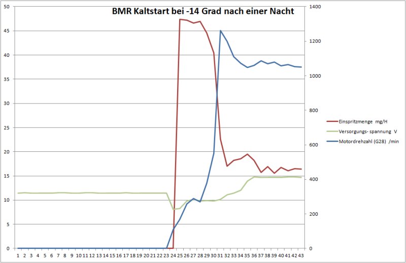

Comisch.
What's so different about -10 degrees Celsius that it allows the engine to start normally (with the third compression) under those conditions?
Log with TURBO button.

Counter question:
Which parameter determines the final launch decision?
I don't see anything that changes at the end of the "orgling" process and can be interpreted as "Okay, enough 'orgling', now he can ignite."

mullemaus wrote: | Depending on the temperature, there is a temperature threshold. The colder it is, the longer it runs, in order to ensure, among other things, that the oil supply is maintained. This relates to "thick" oil. This is intentional and has nothing to do with the battery .
Older TDi engines had something like that, you might know it from the cold start behavior. A minimum RPM must be reached before any fuel is injected. | This is still applied even today.  But Martin's log in the initial post seems to indicate something different:
As the organ's speed increases, the EM (electromagnetic starter) immediately jumps to its maximum value. Then, with the full starting current applied, it continues to "urge" the motor slightly before finally engaging.
If a few organ rotations before starting were explicitly desired, what would be more appropriate than not injecting anything during that time? }
