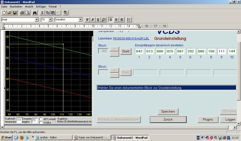

I've now run the actuator diagnostics, and I can hear a knocking sound every second, which then returns to normal operation. Is that normal?
Then I used the TDI Timing Checker, and the injection timing is fluctuating between 71 and 76, as you can see in the picture. I can only check the resistance of the valve tomorrow!

Actuator diagnosis = OK.
In the image with the timing checker, the text at the bottom, which is slightly difficult to read, says: "Engine (coolant temperature) too cold. This means you first need to bring the engine temperature up to 85°."
If you've selected the correct engine in the timing checker, the injection timing is still too early.
But first, let's measure again and confirm the engine.
Is the main bolt tightened?
Translated on 14-10-2026, 22:02.
