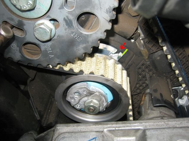

Joined: 04/14/2012
Posts: 2130
Location: Nähe Düsseldorf
Post04-06-2013, 21:52    Subject: Synchronization angle 16V PD Germany (SOLVED) Quote
Nach festziehen der Spannrolle war der Zeiger ca. 5mm weiter links, was normal sein sollte.
You need to think about that again.
The belt is adjusted too loosely! The tension indicates that the belt needs to be replaced. If the rear bracket of the tensioner hits its limit, it will fly off and hit you in the ear.
The same applies to the end stop!
And – importantly -> the roller must only be turned to the right (clockwise) for tension adjustment. If the belt is too tight, completely release the tension and then re-tension it by turning it to the right again.
The correct tension is achieved when the markings (photo) on the tension roller are aligned.
Here's how to proceed:
- Manually rotate the motor clockwise to the designated position (do not engage the locking mechanism!).
- ZR - Check the tension as described and adjust if necessary. Tighten the tensioner roller with a torque of 20 Nm.
- Rotate the motor two more revolutions - check the voltage. If the voltage is okay, pull the tensioner 45 degrees - move to the next point.
- Rotate the engine approximately two more revolutions until the crankshaft stopper can be engaged with the crankshaft.
- Continue rotating the motor slowly until the crankshaft stopper can be inserted straight into the fixing hole. Now, secure the flywheel and make any necessary adjustments.
Also, erst die Spannung, dann die Steuerzeiten. Viel Spaß dabei. icon_wink.gif
And one more thing, what did you use to check the synchronization angle?
Please enter your VCDS serial number under "Settings".
 Spannrolle AXR, richtige Einstellung der Zahnriemenspannung.
 File size:  66.77 KB
 Viewed:  10561 times
Translated on 13-07-2026, 13:15.

B.C.
Joined: 11/28/2004
Posts: 54
Post05-06-2013, 20:18    Subject: Synchronization angle 16V PD Germany (SOLVED) Quote
Thank you both for the information.
@ Herbert: da habe ich mich nicht genau ausgedrückt, sorry. Lt. meiner Unterlagen sollen die Nockenwellenzahnräder vor dem Auflegen des Zahnriemens gelöst und auf Rechtsanschlag gedreht werden. Die Nockenwellen selbst bleiben abgesteckt. Durch das Spannen drehen sich die Nockenwellenzahnräder nach links, so daß auch auf der Zugseite gespannt wird und auch die Spannung zwischen den Zahnrädern stimmt. ZAdditionally, after tensioning, the left camshaft sprocket should be held in place by pulling it counterclockwise (using the holding tool T10172) while tightening the camshaft sprockets.
The purpose of this procedure is likely also to ensure that the valve timing is correct after the tensioning process.
Is there sufficient tension between the camshaft gears?
@Onkel BM: auch an Dich erstmal eine Entschuldigung - ich habe rechts/links verwechselt.... icon_redface.gif
Ich hatte den Zahnriemen entspr. Deines Fotos eingestellt. Then 20 Nm plus 45 degrees.
Nicht erst 2 Umdrehungen und dann 45°. Stand in meinen Unterlagen (VAG) nicht so. Abgesteckt waren die Nockenwellen, die Nockenwellenzahnräder waren aber gelöst (s.o.). Nach dem Anziehen von den 45° ist der Zeiger nach rechts (ca. 3mm gewandert). Danach habe ich den Motor mindestens 4 Umdrehungen durch gedreht, dabei immer wieder abgesteckt und die Riemenspannung kontrolliert. Alles okay. Dann wieder 4 Umdrehungen durchgedreht. Danach war der Zeiger nach links gewandert. Ca. 2mm links von der Markierung. Ah, I thought, the timing belt must have stretched a bit.
The tensioner's locking mechanism has been released, and it was tightened by turning it to the right (clockwise) until the marking was reached. Then, it was tightened again by 20 Nm + 45 degrees without over-tightening (see above). The indicator needle has moved approximately 3 mm to the right.
Okay, I thought, because there is a note in the documentation: When tightening the mounting nut, the pointer moves a maximum of 5mm to the right out of the slot on the base plate. This position must not be adjusted, as the timing belt will settle after a certain period of use.
Today, I removed the upper timing belt cover as you suggested, and I can see that the indicator is even further to the right after driving 40 kilometers (see photo, green marking). I just measured it on the old tensioner pulley. It's about 6mm, not 5!
Is the belt too tight now? Do I need to disassemble everything again (including putting the lock carrier back into service mode, etc.) and readjust it?
Or is this still acceptable right now?
I haven't been able to afford VCDS yet. I'm using a VAGCom version that I bought from RossTech some time ago.
VG
Björn.
 File size:  93.08 KB
 Viewed:  4861 times
Translated on 13-07-2026, 13:20.
Joined: 04/14/2012
Posts: 2130
Post05-06-2013, 23:12    Subject: Synchronization angle 16V PD Germany (SOLVED) Quote
You need to adjust it --> it's far too tight. You're only 4-5mm away from the limit (see post). When the motor reaches operating temperature, there might already be contact. There is significantly more room in the "loose" direction. If you leave it like this, you're leaving the rest of the engine's life to chance...
It's not just 2 rotations and then 45°. The information in my documentation (VAG) wasn't stated that way.
There are also people working there who can do this perfectly right away and understand what they're doing. Also, the film doesn't jam when threading because it hasn't been pulled too tightly beforehand; instead, the tension remains exactly the same after it's engaged.
The studs are delicate and essentially undersized, not suitable for repeated adjustments of the angle. I replace them every time I change the timing belt. Who knows who might have tightened them before, possibly overtightening them.
Therefore, adjust the timing for non-experts only when the engine is running correctly, or after the motor has reached its maximum speed and is still running smoothly.
You've probably messed with it too much; you can just throw away the stud bolt.
The instructions were already specifically for "you." Inserting and tensioning can only be done with the NW wheels loosened - that's a given. But why loosen them again now? You only do that "in this case" if the valve timing will no longer be correct afterward. Therefore, DO NOT insert it, but check the tension in this position!

B.C.
Joined: 11/28/2004
Posts: 54
mae1988 likes this.
Post06-06-2013, 13:50    Subject: Synchronization angle 16V PD Germany (SOLVED) Quote
I don't understand... Today I brought the engine with the second gear engaged to Top Dead Center (TDC), and to check the TDC position, I marked both camshafts and paid attention to the marking on the lower pulley. And what do you know, the indicator on the tensioner was exactly in the middle of the recess!
Okay, perfect. The motor spun three more times and then stopped; everything is fine now.
Engine started and ignition timing measured: 1.49 degrees (engine cold, idle).
Engine warmed up and measurements taken. 1.09 degrees at idle.
It was about 0.74 degrees shortly after assembly.
Has the belt settled in now?
The tension seems to be just right now, doesn't it?
Can I leave it like this now?
VG
Translated on 13-07-2026, 13:32.

And the tensioning. So yes, even the inspection of the timing belt tension is performed in the "KW" (eccentric shaft) position: Top Dead Center (TDC).
If you continue to turn it, the tension changes, as described yesterday. In some KW positions, it becomes tighter until it reaches the maximum value (photo, pink marking). As I said, I attributed this behavior to the "oval" crankshaft gear.
VG
Björn.
Translated on 13-07-2026, 13:41.
Joined: 04/14/2012
Posts: 2130
Post07-06-2013, 15:17    Subject: Synchronization angle 16V PD Germany (SOLVED) Quote
Actually, the timing gear is not oval, but has two areas offset by 180 degrees with larger tooth gaps.
With this toothing with larger gaps, the ZRP (Zero-Point Regulator) is engaged in the TDC (Top Dead Center) area.http://www.litens.com/belttension2.cfm
That was already the case with the round wheels.
The oval wheel originally came from Litens (developed in 2004).
Und ich dachte, die Entwicklung wäre von Schäffler.
Aunt Edit:
Also ist das Rad doch oval. Dort steht: a>b. Die Aufnahme schein mittig zu sein. Somit könnte auch der Zeigerausschlag bis zu der rosa Markierung hinkommen? icon_wink.gif
Don't act like that now... } The ZR voltage is set in the designated position, not at any random point. And it must be correct at precisely that position - period. Everything else will follow from there. It doesn't matter whether the wheel is round, oval, or triangular.
The rest is already described. Why make simple things so complicated?
Of course, one would not want to remove the timing chain tensioner at tax time.
You only need to offset the camshafts by a small amount (approximately 0.5 degrees of crankshaft rotation) relative to the cam gears in the direction of rotation, or offset the cam gears accordingly against the direction of rotation.
What's the problem here? Just think logically for a moment.

So, the dial seems to be oval. It says "a > b" there. The indicator appears to be centered. Therefore, could the needle swing all the way up to the pink marking?
Regarding the valve timing correction: if I understand correctly, I only need to loosen the camshaft sprockets (after disconnecting them) and then tighten the tensioner tower? That is, in a counter-clockwise direction. If that's the case, is it absolutely necessary to use a crankshaft locking tool? Or, if the camshafts are disconnected, can I block the crankshaft by engaging first gear and using the handbrake? This would save a lot of work, and I would only need to obtain a holding tool (T10172) or improvise something.
