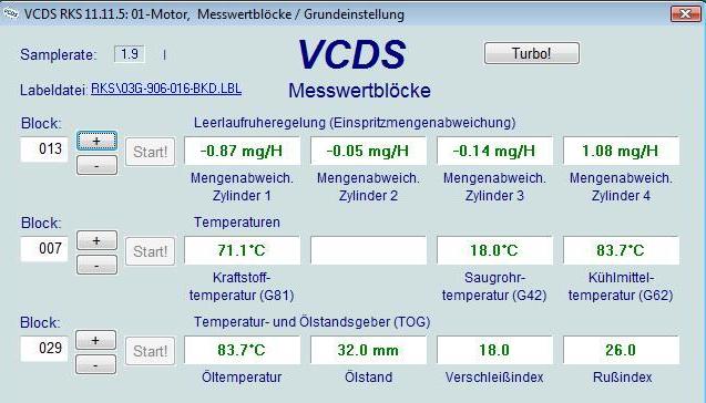

Post31-03-2013, 22:03    Subject: Octavia 2.0L TDI BKD Problems - Solved Quote
Here are the temperatures in a cold state.
Coolant temperature: 15.3°C.
Oil: 26.1°C
Fuel: 13.5°C
Intake manifold: 6.3°C
Clutch: 17.1°C
Then I looked at the MWB 013 while it was in a warm state. Are those values/deviations normal? icon_eek.gif
Thank you for your help.
The Octi must be running perfectly in 4 weeks, because a vacation to the WĂśrtersee is planned (1200 km). icon_rolleyes.gif

Posts: 18064
Post31-03-2013, 22:07    Subject: Octavia 2.0L TDI BKD Problems - Solved Quote
"Normal... but that's how he normally drives, right?"
So, why shouldn't the values be normal during the time when the car is driving normally? icon_rolleyes.gif
What does the person asking the question learn from this?
Translated on 10-08-2026, 23:19.
gtikasper
Joined: 03/06/2013
Posts: 33
Post31-03-2013, 22:29    Subject: Octavia 2.0L TDI BKD Problems - Solved Quote
icon_sad.gif I have absolutely no idea about that. The technology is unfortunately too new or not as simple as it was with a Golf 2.
Then I won't see anything during a logging operation, even under full load, because it only happens at partial load, right?
This car is driving me crazy icon_lol.gif.
Translated on 10-08-2026, 23:20.
Posts: 18064
Post31-03-2013, 22:30    Subject: Octavia 2.0L TDI BKD Problems - Solved Quote
dieselschrauber wrote:
What does the person asking the question learn from it?
Um... the log should primarily contain information about the stuttering, right?
Translated on 10-08-2026, 23:21.
