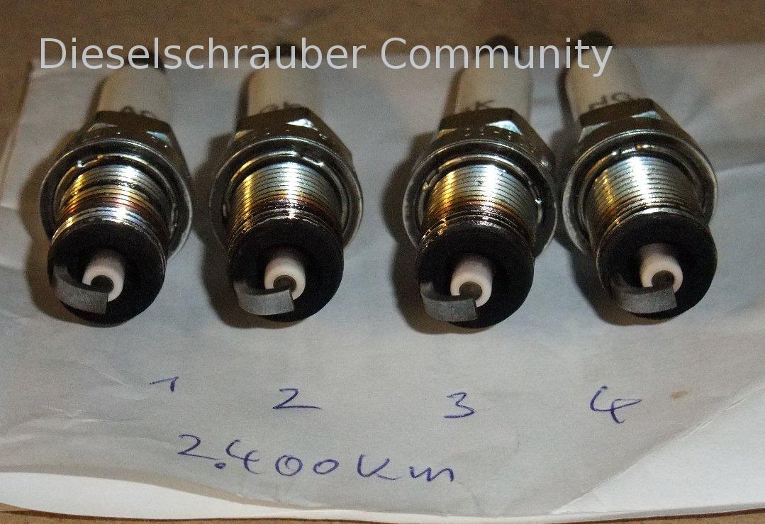

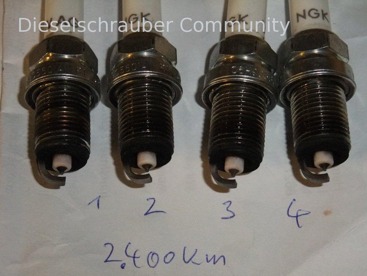

My CDLJ, which currently has 2400 km on the odometer, gave me a bit of a scare yesterday: after a brisk 240 km ride, mostly at 120-150 km/h (with a few times exceeding 200 km/h), the oil level is about 3 mm below the mark on the dipstick.
I always check the oil level in the garage, after the car has been stationary for at least one night.
The engine block is completely dry (no oil leaks), and there are the usual few drops of oil in the turbocharger pipes.
I think the faces in the photos also look normal, see the attachment.

The candles in the photo look fine.

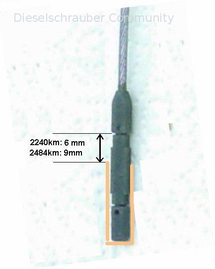

Is it certain that the oil level was previously filled to the maximum mark?
No, both readings are within the middle, ribbed section of the dipstick, see attachment.
To determine how much 3mm corresponds to on the dipstick, you fill it up in 100ml increments until you reach the "Max" level.
The experiment is currently underway. I added 0.2 liters earlier, and I'll check the dipstick again this evening. The Polo will not be moved today.

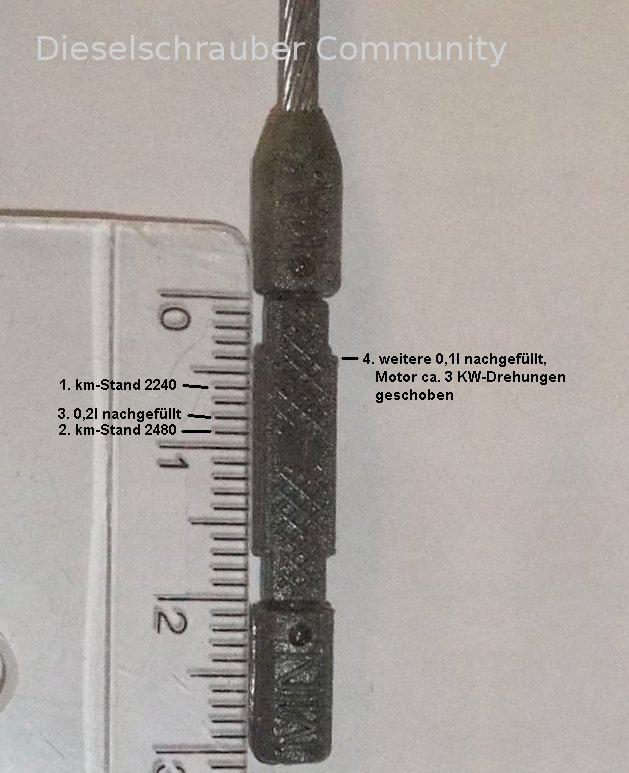

Okay, now I'm completely confused.
I have tried to explain the reason in the attachment.
The numbers 1 through 4 indicate the order of my check-ups.
After the initial 3 liters, I added another 0.1 liters of oil (for a total of 0.3 liters) because 0.2 liters, after waiting for about 8 hours, only raised the oil level on the dipstick by approximately 1 mm.
After that, I wanted to perform a rough compression test: I wanted to manually push the car, with the engine off and in 6th gear, through at least four compression strokes and pay attention to the varying amount of force required. However, it didn't yield any conclusive results.
Approximately 2 hours later, I checked the oil level again, and I couldn't believe my eyes: there was about 4mm more oil on the dipstick than there was during the previous check!
To be sure, I completely dried the dipstick and checked it again -> same result.
How does this work???

Nach 3. habe ich weitere 0,1 Liter Öl nachgefüllt (also insgesamt 0,3 Liter), weil 0,2 Liter nach gut 8 Stunden Warten nur ca. 1mm am Peilstab brachten.
Vielleicht weil du mit dem eingefüllten Öl einer der zahlreichen Taschen im ZK, wo nun mal Öl stehen bleibt, erst mal gefüllt hast. icon_wink.gif
With such small amounts, you should drive a certain distance to ensure you have the same conditions. Otherwise, icon_wink.gif two shot glasses full can easily accumulate somewhere before reaching the oil pan.

Maybe because you first filled one of the numerous pockets in the ZK (which are designed to hold oil) with the oil that was already in it. icon_wink.gif
I understand what you mean. But the pockets can only accept freshly added oil if they weren't already completely full. The question here is: How is oil removed from the pockets during operation?
Do the valve stems of open valves create such large pockets that more than ~0.1 liters can accumulate there after the engine is turned off, instead of draining back into the oil pan? I would have emptied those pockets with just a few engine rotations, and the oil from them would then have drained back into the pan.
