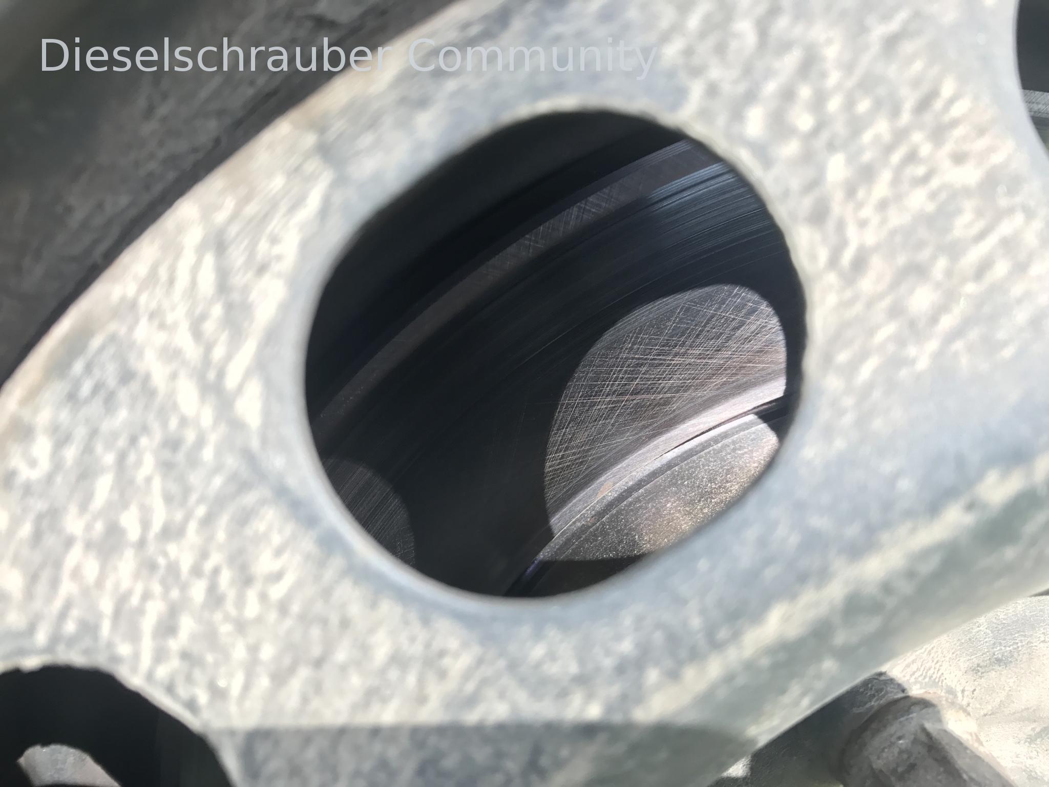

Post26-04-2017, 11:23    Subject: Rear brakes intermittently sticking on Octavia RS TDI Quote
"Everything is easy to operate. The brake pads release easily and fit perfectly. I've tested the handbrake in all settings, from very loose to fully engaged. Currently, it engages after about 5 teeth. This matches the readings I got from the Audi that's still here. It also engages after 5-6 teeth."
Could the HBZ be the cause? That would be the next "convenient" alternative to exchanging [something].
The brakes themselves don't present any problems. The pedal feels the same as always.
Due to the ABS system - the manual states that after bleeding the brakes, you should perform the basic adjustment.
Here's the translation:
"It also states: If the brake pads are new or far from the wear limit, the brake fluid level should be between the minimum and maximum marks. I think they mean it should be in the middle. I've already disabled my Hill Hold Control (HHC), but without success."
Sometimes I miss my old Golf Mk2.
Edit: Just after 26 km, I'm already stinky and hot again. The wear pattern on the tires looks a bit strange.
Regards,
Daniel[/img].

Post26-04-2017, 21:48    Subject: Rear brakes intermittently sticking on Octavia RS TDI Quote
Think about it. We're talking about a diagonal two-circuit brake system.
It is simply impossible for the master cylinder in a brake circuit to cause a malfunction at the rear while not causing one at the front.
The fluid level is not relevant; the instructions only address adjustments based on wear of the disc.
Again, what about the path of the handbrake lever?

Herbert wrote:
Think about it. We're talking about a diagonal dual-circuit brake system.
It's not entirely impossible; in fact, I've encountered swollen brake hoses twice that have obstructed the return flow of brake fluid.
The bearing surface looks suspicious; are the saddle guide bolts excessively loose and potentially misaligned?
