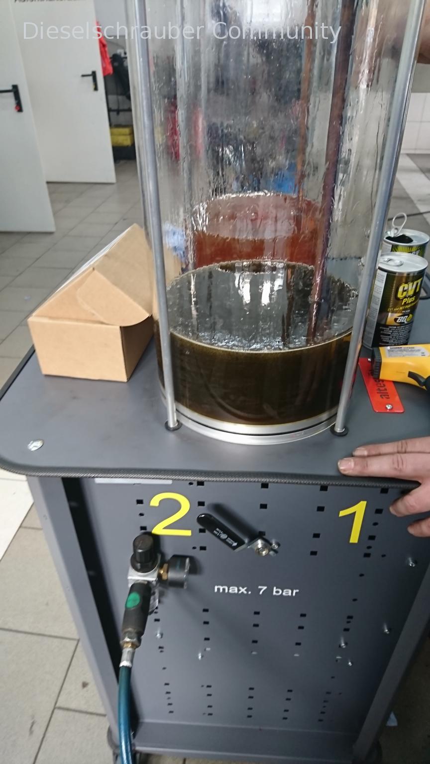

Regarding my DSG, the interval is also 60,000 Km, and this has always been adhered to. So, at 60,000; 120,000; and 180,000 Km, I always had an oil change with a filter change. At 205,000 Km, I had a flush performed, as my friend's workshop had acquired a flushing machine. This means I had it flushed at half the interval, and the gear oil looked like in the picture. Since then, the gearbox has shifted much better, but this problem with the 'thud' had already occurred before, and it didn't change much after the flush. It has become a little quieter and less noticeable. Therefore, it can be ruled out that the flush caused any problems. She has even done it a little better.
