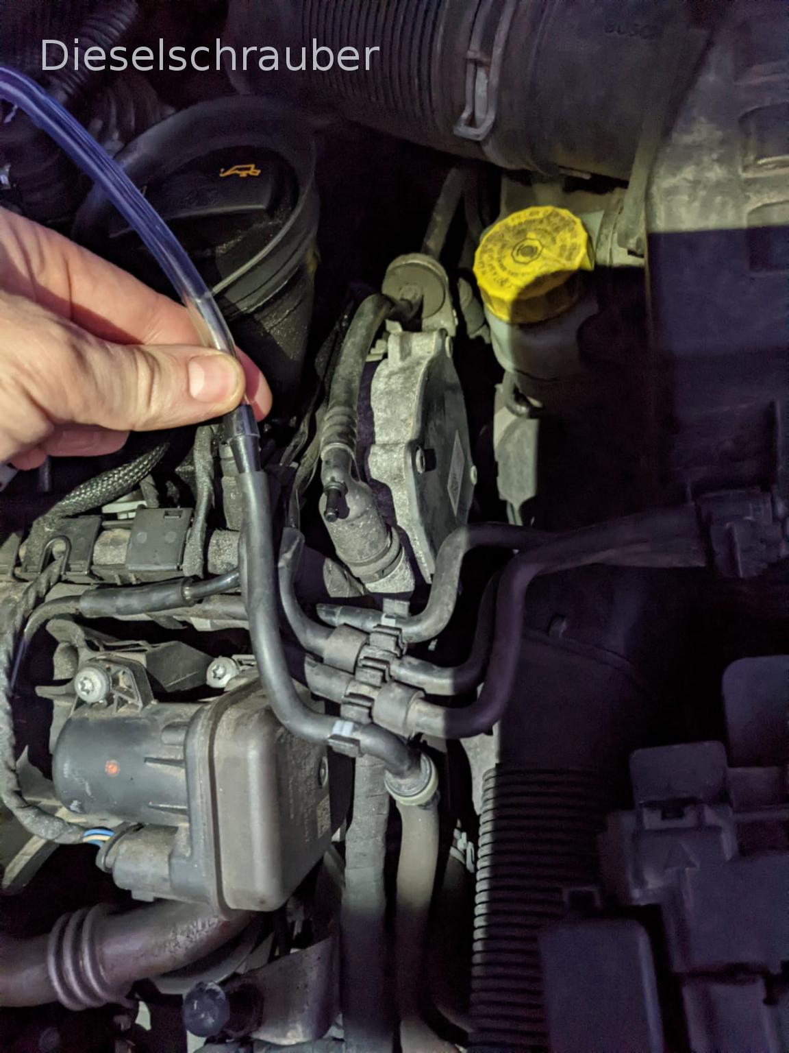

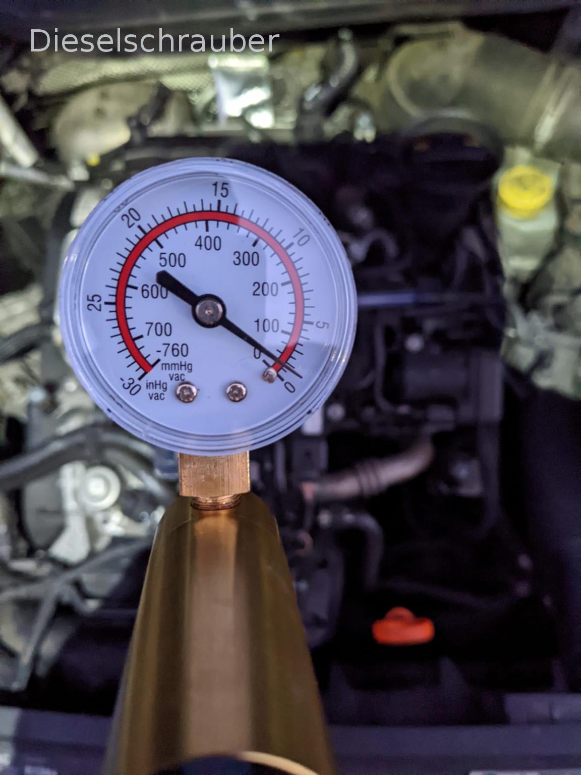

After a visit to the workshop, it was stated that the VTG adjustment mechanism is stuck or carbonized and that the turbocharger needs to be replaced. However, I find it hard to believe this, as the problem didn't always occur and I couldn't reproduce it. I drove the car on an extended test drive on the highway for 100 km. I tested it under various load conditions, including sudden acceleration and reaching the maximum speed. No errors occurred. The next day, the errors reappeared in city traffic. I manually actuated the pressure sensor of the turbocharger with a pump, and the rod moved visibly (how far should it move?). The sensor also maintained the vacuum. Then, I tested the vacuum system with the pump. I disconnected a small hose from the vacuum pump and applied vacuum. The vacuum was maintained here as well, although only minimally (see picture), but it was maintained.
