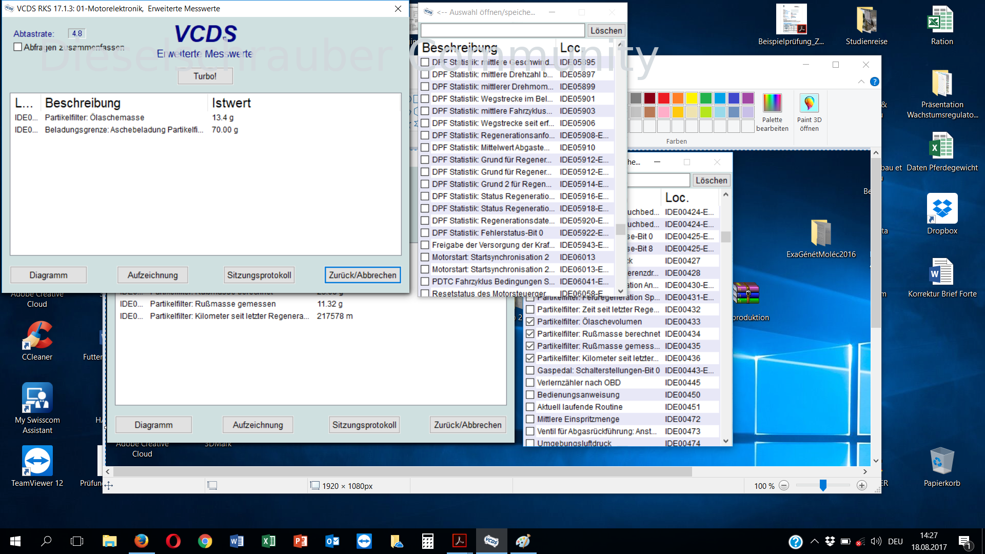

Post18-08-2017, 14:02    Subject: EA189 Update: Stuttering & Loud Burning Noise? Quote
Attached is the oil residue; I'll observe how it develops further.
