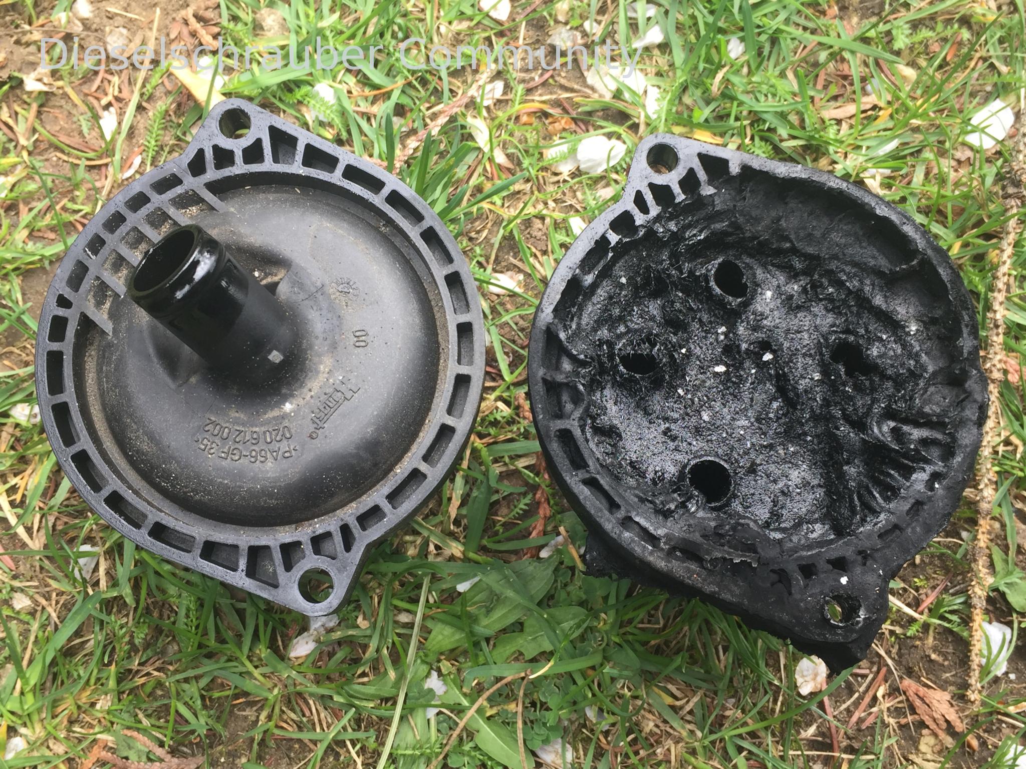

Normally, the cyclone filter lasts forever.
It merged into a clump because the EGR pipe broke and the exhaust gases blew onto the oil filter housing. I bought a used oil filter housing with all the necessary parts for around 30 euros.
I'd like to keep driving my Allroad for a while longer. In February, it will be 10 years that we've shared fun (and some frustrations) together.
How many kilometers are on yours?
 Kurbelwellengehäuseentlüftung / Zyklonfilter 2.5l V6 TDI
