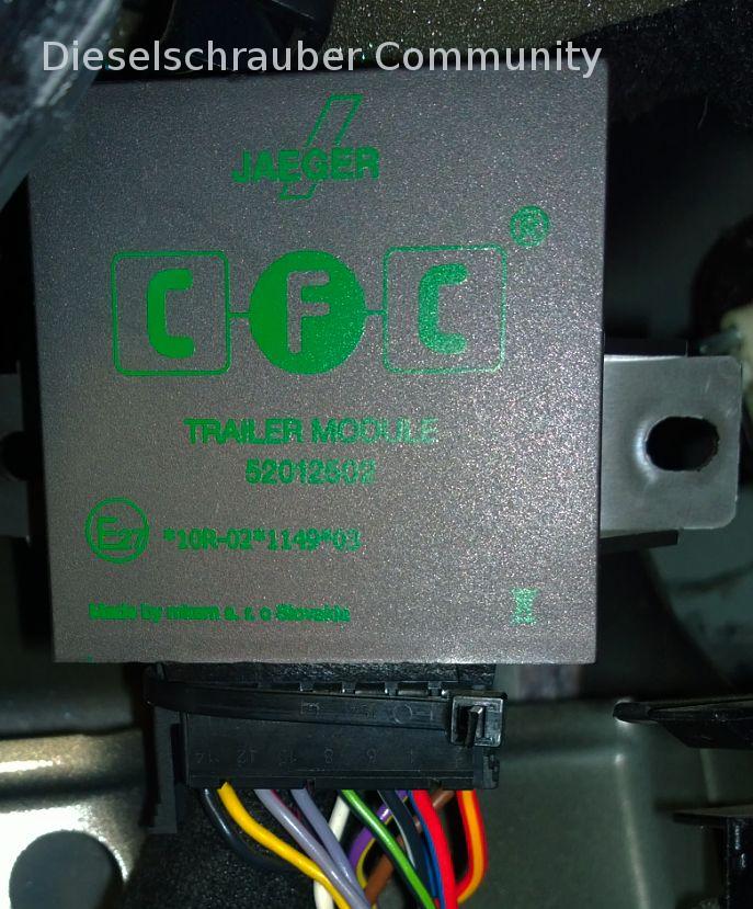

I went to the TÜV (technical inspection) today... The inspector wanted to turn off the ESP (Electronic Stability Program), but he couldn't. He tried pressing the button for a long time, then briefly, turning the ignition on and off, and repeating the process several times... it didn't work. The light for ASR (Anti-Slip Regulation) comes on briefly when you press the button, but immediately turns off again. There is no message in the instrument cluster indicating that ASR or ESP is off.
According to the operating instructions, you need to press and hold the button for a longer time to turn off ESP. A short press allows you to switch ASR on or off.
I bought the car in April. I believe it was working then, but I never actually needed to use that feature.
Since then, the only suspicious issues have been various reports of coding problems related to the AHK control unit, specifically a known error code J345 indicating intermittent communication failures.
It appears to be equipped with a Jaeger electrical wiring harness. In the Gateway 19 module, option 69 (AHK - trailer hitch) is selected. Similarly, both the AAS (Adaptive Air Suspension) and ESP (Electronic Stability Program) control units have "AHK" registered in their configurations.
I tried to clear the errors months ago, but they keep reappearing. The AHK (Auxiliary Heating System) also works, and when I plug in the bike rack, the car recognizes it, turns off the parking sensors, and the lights function as they should.
Now I'm always reading that for other people, the error messages and the retrofitted AHK (Auxiliary Heating Control) have cleared errors in the STG 69 control unit, and further settings are still possible. However, I've never been able to access the STG 69. Somewhere it was stated that it's not diagnosable, so I haven't tried any further troubleshooting. Despite the error messages, everything has been working fine so far.
Okay, so today I tried all sorts of things again. I enabled and disabled the cruise control, and encoded/decoded the trailer hitch... The coding is now back to how it was when I bought the car, and I have an old Autoscan for comparison. The ESP button also shows up correctly in the diagnostic data as pressed and unpressed.
So far so good, but the ESP (Electronic Stability Program) remains active, and the light turns off immediately without any warning message!
Does anyone have any ideas? Is there possibly something wrong electrically?
Das JAEGER MODUL hat die Nummer 52012502, wenn ich das richtig gesehen habe. Sollte ich das mit Adresse 69 finden und aufrufen können? Does anyone know about this?
I'm grateful for any ideas. Does anyone know the conditions under which ESP or ASR can be deactivated?
Is there a way to see in the ESP control unit whether ASR/ESP is active or why it's being reactivated? Could it be that the instrument cluster (IC) isn't displaying this information correctly?
In the A6 Friends forum, I once found a similar case, but it was from 2012, and at that time, the cause could not be determined. There are quite a few specialists here... it would be great if I could get some helpful advice.

 Jaeger AHK Modul

Revert everything back to the original settings, especially the AAS (Advanced Adaptive System) and the braking electronics. Just because you can select an option for a trailer hitch doesn't mean it's necessarily correct. The individual control units are also installed in other vehicle models that might need them, but not in your case.
The trailer hitch is only active in the PDC (Parking Distance Control) and the central electrical system. I had a similar problem with a Passat from 2008; it also had the trailer hitch coded everywhere, resulting in non-erasable errors and "Christmas lights" on the dashboard. Then, I copied the AHK coding from another Passat, and it worked fine. It was only coded into the body control module (BCM), as that module only needs to know that there's a trailer with its own lights, turn signals, and brake light.With PDC, there's still the issue of deactivation when operating in AHK mode; everything else remains standard icon_wink.gif.
The error in the gateway persists because the accessory control unit cannot be accessed.
