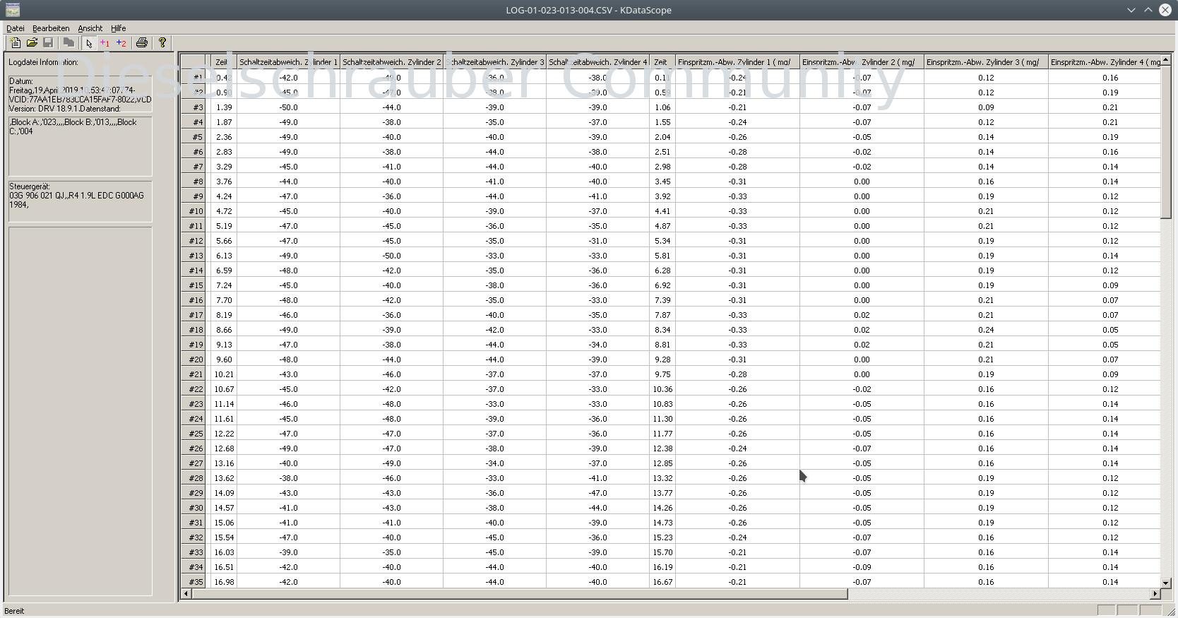

Hello Rainer,
"Since I'm new here, and to avoid starting another thread with a question, I've added my comment to this one. If that's not okay, please feel free to move it!"
Wenn ich die angehängte Log-Datei mit KDatascope öffne, sehe ich die Kurven, das funktioniert schonmal! icon_smile_thumb_up.gif Wenn ich aber in der Ansicht auf 3D-Map, oder Rohdaten wechsel, dauert es einen kurzen Augenblick und KDatascope ist vom Bildschirm verschwunden. icon_eek.gif
I've already uninstalled and reinstalled the version from my customer account in the store three times...
What can I do? What am I doing wrong?

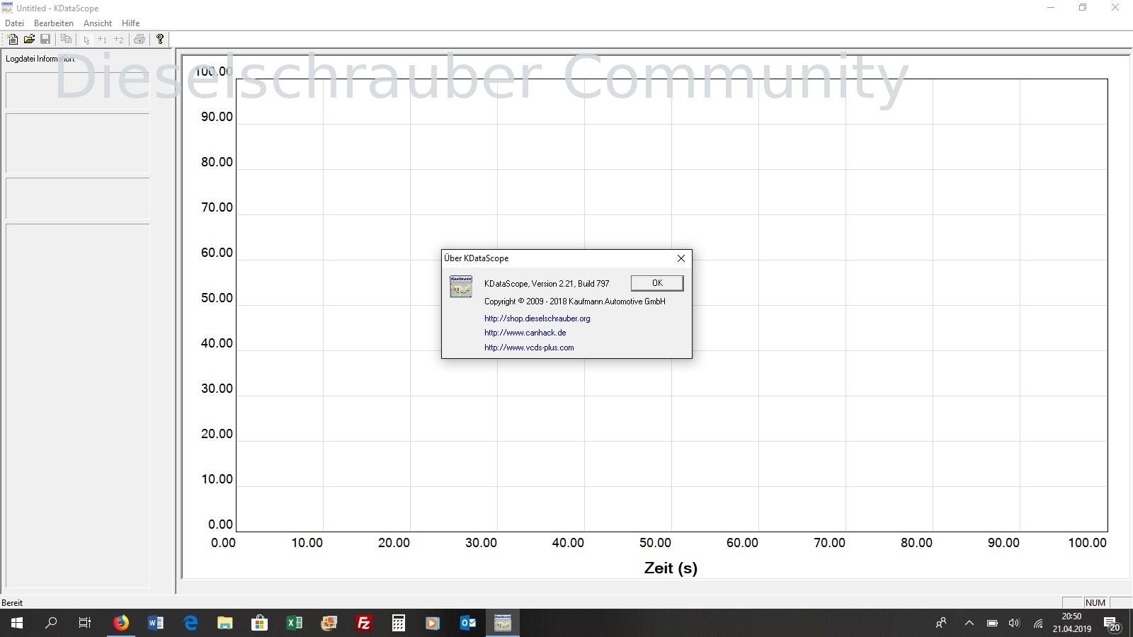

It works perfectly for me. Which version of KDataScope and which build number are you using? Go to Menu -> Help -> About...
Which version of KDataScope was installed, the German or English one? And on which computer, with what operating system?
Is it possible that an antivirus program that's installed is malfunctioning or causing problems?

Post21-04-2019, 20:57    Subject: KDataScope cannot be executed Quote
Daanke für die schnelle Antwort! Hätte aber locker nach den Feiertagen gereicht! icon_wink.gif
German version installed, Windows 10...
I appreciate the tip about the antivirus scanner and will definitely check that out now!
Thank you very much!
