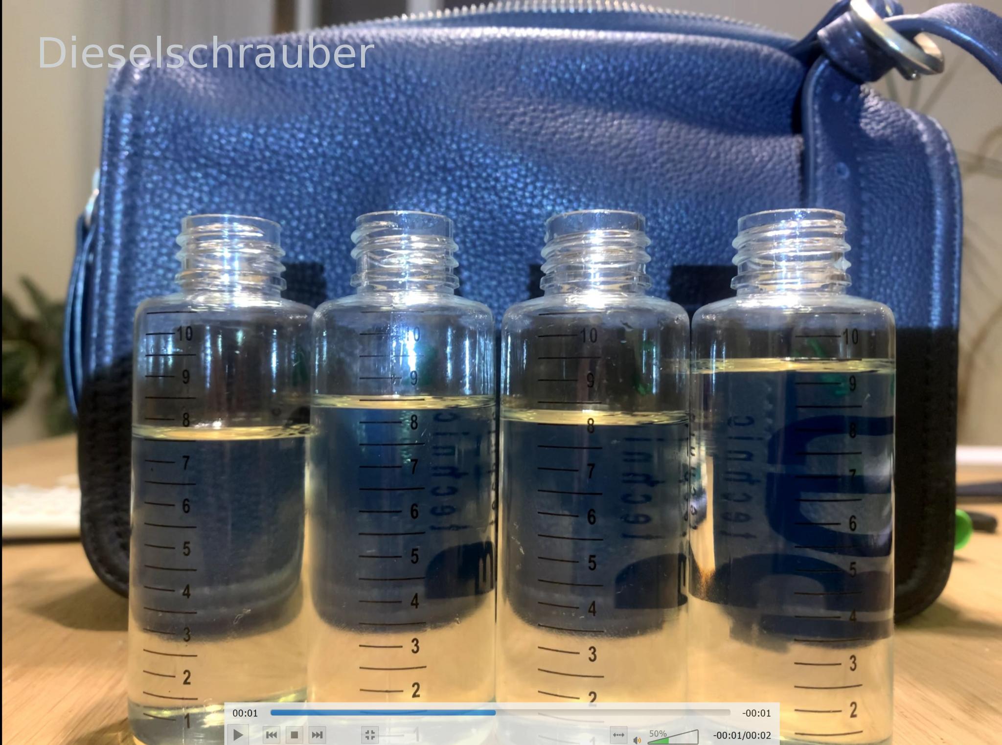

The problem is that the car constantly enters regeneration mode - after approximately 20 kilometers driven. I observed that the measured soot mass increases rapidly. It rises to about 24g, while the calculated soot mass only increases very slowly, remaining between 1-2g. Once the measured value reaches 24g, it is adopted as the calculated value, and regeneration begins. This is indicated by an increase in exhaust gas temperature to 600 degrees on bank 1, sensor 1 (IDE00167). While driving, the calculated soot value quickly returns to normal, while the measured value decreases very slowly to 15g, then briefly increases again, and then decreases again. But never for such a long duration during the drive (tested for approximately 40 minutes on the highway) that it could complete the regeneration process.
I then drove to a rest stop. I didn't turn off the engine and observed that the exhaust gas temperature remained high. The measured value at idle, with the engine running, quickly dropped to around 7 grams, and then the regeneration process ended (according to the last regeneration recorded by VCDS). I then continued driving, and the same thing happened again and again, just like before. I have already replaced the differential pressure sensor.
The car has 110,000 km and has a good mix of long-distance and short-distance driving (70:30). The oil level is increasing due to the frequent regenerative braking (oil dilution with diesel). I changed the oil about 2 weeks ago when this behavior became noticeable. I also replaced the diesel filter and the oil filter. There is no visible smoke, neither white, black, nor blue, coming from the exhaust. Also während der Fahrt (observed from a following car).
The back pressure fluctuates between 10 hPa at idle and 250 hPa when the engine is running at full load. The DPF reading is at 40g, which is slightly more than half full.
I have reviewed the quantity deviations for the injectors and have the following values available. They jump a lot.
Zy1: between -0.2 and -0.5.
Zy2: between -1.2 and -1.5.
Zy3: between 0.8 and 1.3.
Zy4: between 1.3 and 2.2.
Then I checked the values during the regeneration process, and they looked disastrous.
Zy1: between -6 and -7.
Zy2: between -6 and -7.
Zy3: between 6 and 7.
Zy4: between 6 and 7.
After that, I performed a reflux test (approximately 5-6 minutes).
Injector 1: 75ml
Injector 2: 83ml (this injector was replaced 10,000 km ago).
Injector 3: 80ml
Injector 4: 95ml
The error memory is clear and shows no fault codes. The EGR valve and throttle valve have been tested with VDS and are functioning correctly. The next step is to have the injectors tested. However, could this alone be the cause of the regeneration issues? And, more importantly, where is all this soot coming from in such a short time?
I am grateful for any ideas or help. The error memory has no reported entries and is clear. The AGR (Abgasrückführung) and throttle valve tests with VDS (Vehicle Diagnostic System) are functioning correctly.

Okay, so if you didn't get any error codes after the EGR test, then generally everything is fine for now. I've already been through all of this with my P2002 error, which was related to the ND EGR valve. How much carbon buildup there is on the valves doesn't really matter at this point, because the air being drawn in is combined through a single pipe before it splits into sections 1, 2, 3, and 4. It's possible that the design of the part is the reason why 3/4 of them are carbonized.
Return flow tests are indeed not very informative unless you collect a liter of fuel in one minute with a 1.6 TDI engine, or you have 20ml in one container and 250ml in another. However, neither the return flow test, nor the fuel injection quantity deviation, nor the rail pressure calibration points indicate whether a specific injector is working or not (what is meant is that these are only values to be used as a reference for more in-depth troubleshooting, such as injector testing on a test bench). I strongly suspect that at least one of your injectors (and I suspect all of them, including the one you replaced, even though it's an original Bosch part and hasn't been refurbished) is faulty, and significantly so.

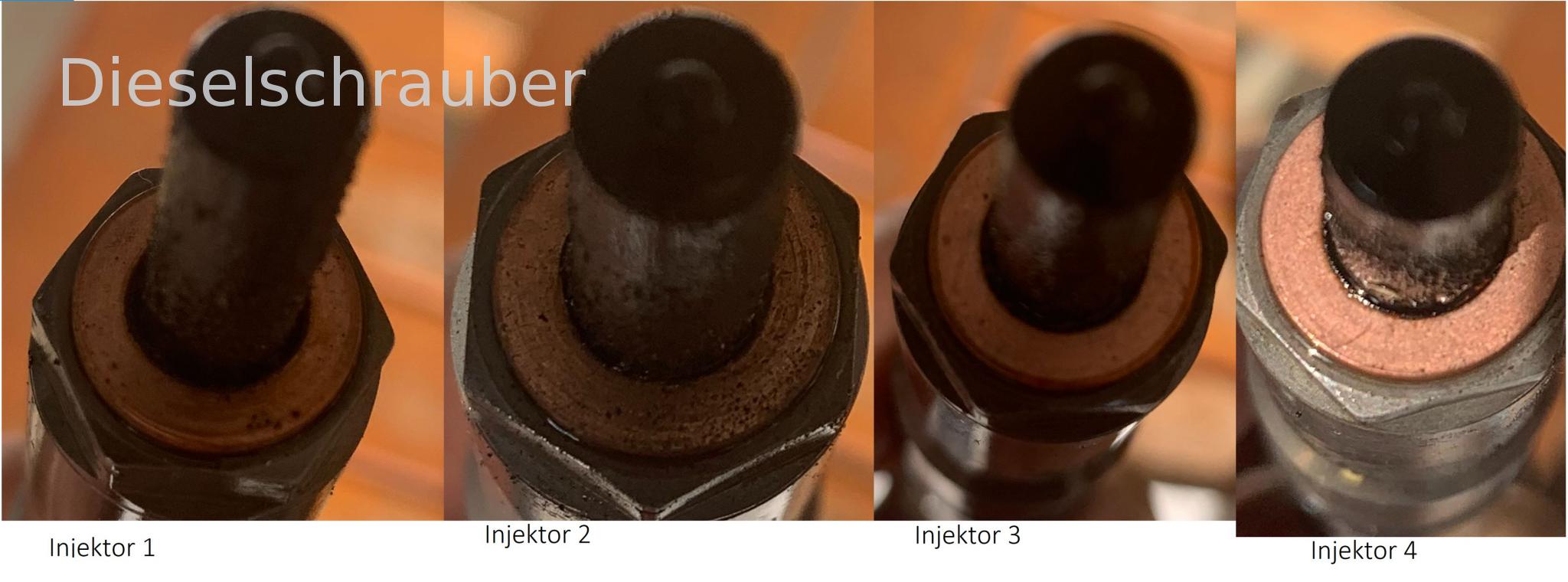

Post22-10-2021, 9:17    Subject: Fuel injectors removed Quote
I've now taken them out and attached the pictures. I was actually expecting something different.

Unfortunately, many of the images are very blurry.
Do you know anyone who has a *good* ultrasonic cleaning device available?
I used this to first clean and thoroughly inspect my injectors after the engine failure. The injector was torn at the top, and the rest of it looked just as corroded.
I find it quite concerning that all four now look like they're not exactly young anymore, especially the one that was recently replaced.
I once removed an injector after about 10,000 km to access the code (which, unfortunately, wasn't visible without removing it), because the workshop hadn't coded the injector.
It certainly didn't look like that yet.
The coding in the control unit matches the deviation codes.
"With those codes displayed? Was the replacement injector a new one?" Then it should work, as long as you don't, for example, confuse the numbers 0 and O.
However, in the case of refurbished products, the new code is usually located on a separate label on the side. But I think you would have discovered that at the latest during the expansion.
The margin of error, however, doesn't look good.
The return volume is perfectly fine.
What just occurred to me:
"With two of the injectors, the copper gasket is quite dirty on the contact surface, and the contact surface on the injector head itself doesn't look entirely clean in the relatively sharp images." It suggests a possible leak in the ZK (likely referring to a Zylinderkopf, or cylinder head), which could explain a number of issues.
Regards,

Here's a sharper image of the copper gaskets.
It probably can't be that leaky, as only slight deposits are visible on the underside of the sealing rings. Above them, they are completely clean. I've seen much worse than that.
The discrepancies in quantities were particularly severe when I initiated a forced regeneration at the station to see how the quantity discrepancies would then manifest. And that's when I nearly fell over.
It also runs unevenly when idling, and up to a speed of 2000 RPM; beyond that, it runs better. I haven't noticed a significant loss in performance, either in acceleration or top speed.
