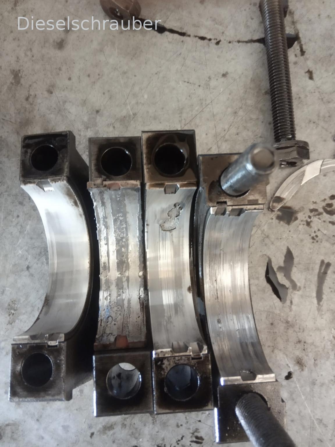

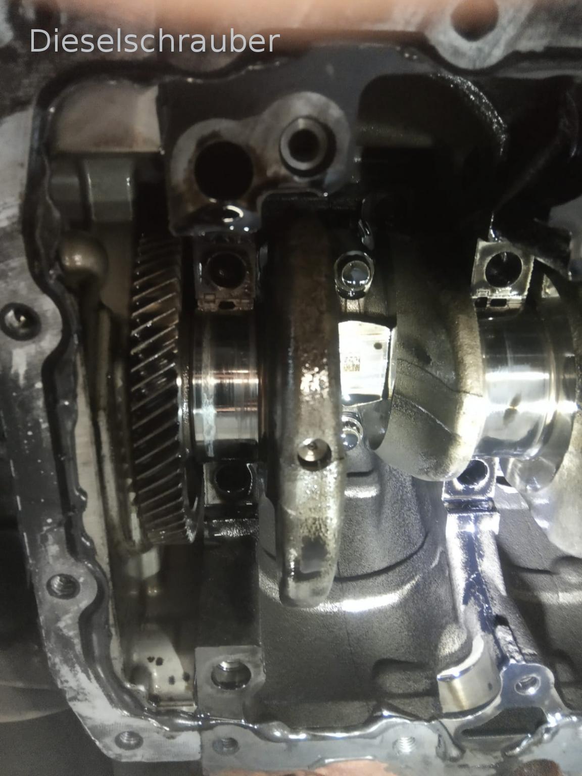

After opening the main warehouse, a disastrous situation was revealed! The crankshaft bearings are all in relatively good condition.
Regarding the main storage areas, I don't need to say much – just take a look for yourselves.
I'm wondering how such damage could have occurred. Oil change intervals were always adhered to (until purchase, all services were performed by VW).

Here you can find various information about bearing damage from Kolbenschmidt:
Specifically, Chapter 5 features images similar to yours.
Was was the block in the manufacturing process, a complete outlier, or has it been worked on before?
I wouldn't spend much time trying to fix it, but I would replace it completely. The block requires the services of a professional repair technician.

Thank you very much for the link to this extremely interesting page. Actually, there is a clear similarity to the images in Chapter 5.
Overheating, Oil Quality: Oil changes have all been documented (previous owner). Since I have the car, oil changes have been performed every 15,000 miles. LL would also have been possible with the oil I was using - but I never really optimized it.
Since all the crankshaft bearings were in good condition, I don't really anticipate any oil-related problems. Also, overheating.
According to the previous owner, nothing has been done to the engine. The VW history confirms this. Services, on the other hand, were performed by the previous owner at VW.
During today's disassembly work, it became clear that the oil pan was definitely damaged (this is clear). The reason for this is currently unknown. It is possible that the damage occurred before my time, and although the main bearing shells were replaced, the crankshaft was also damaged. This would explain why the connecting rod bearings are generally in good condition. This is just a guess, and of course, I can't prove it.

The pictures above unfortunately speak for themselves.
If there is no marking on the crank shaft journal, or if it is relatively easy to remove, and the journal bearings are still in decent condition:
Keep a close eye on the vehicle's value. If I want to continue using the engine, I would check the camshaft and turbocharger for wear and tear. Low oil pressure can easily accelerate wear and tear. If okay, I would simply install new shelves and assemble everything.
This attempt offers manageable costs depending on the effort and provides the opportunity to cover many more kilometers.
In the main storage area shown in the image above, with thick bearing material on the crankshaft, it appears to be in a poor condition, according to my assessment.
Wouldn't it be better to also replace the upper bearing shells? Likely, one would need to remove and completely disassemble the engine, which is probably not worth the effort.
Otherwise, depending on the vehicle's residual value, a used engine with a known history can be a sensible alternative.
Regarding engine oil, I wouldn't focus on the brand, but rather that it meets the exact correct VW specification for the vehicle and that the oil's lifespan isn't unnecessarily extended.
