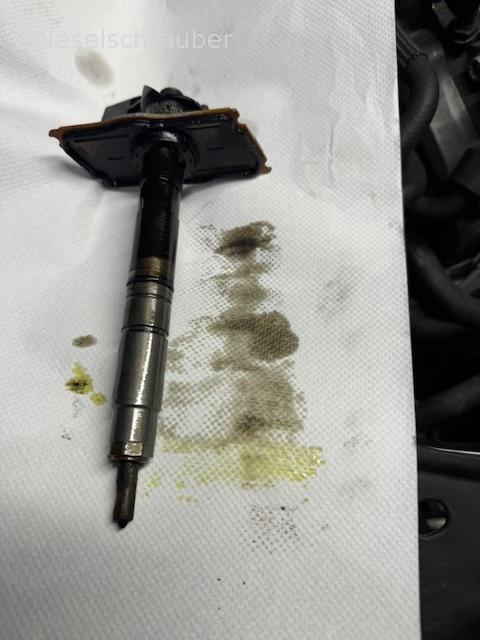

Unfortunately, we haven't been driving the car very often lately, but we have still noticed a significant oil dilution problem.
I changed the oil right before installing the injector. Since then, I've driven 2500 km, and I've noticed approximately 1 liter of diesel in the oil again (within those 2500 km, there were vacation trips of 1000 km, and many of the routes are longer than 20 km, so it's not just short trips).
As far as I can tell, the only way to access the injectors on that engine. Is that correct so far? (There's no tandem pump or anything like that, as with the PD models.)
I then removed the injectors and sent them to Biberach for overhaul. While doing so, I noticed that all the nozzles were full of diesel between the O-ring and the copper ring. So far, I haven't noticed this on any of the CR-TDIs, although I've never really paid attention to it.
I've attached a picture here. You can clearly see on the fabric that diesel fuel (yellow) was applied to the lower part.
Is that correct, or have I found the error with that?
If that's the case, are there any other options for this engine to prevent diesel from getting into the oil?
Thank you very much!

Herbert Profi-Schrauber
Joined: 06/22/2005 Posts: 4619 Karma: +1337 / -0
dieselschrauber likes this. |
18-03-2024, 14:50 Subject: Quantity deviation after injector replacement |
Quote |
What does the F**** D************* in Biberach say about the problem?
Completely neutral, if it were my car, I would have bought a refurbished or new injector from VW (just one, given the mileage). But definitely not sending the other, presumably good, injectors to the Swabian region just to have them "tuned up."
The miraculous increase in oil consumption happened spontaneously after replacing just one injector, so it must be related to that. The diesel injector marking may have been created during the removal process.

guste100 Profi-Schrauber
Joined: 07/27/2004 Posts: 2401 Karma: +438 / -0 Location: Mitte Schleswig Holsteins 2007 Volkswagen Passat Premium Support
dieselschrauber and Herbert likes this. |
26-03-2024, 12:34 Subject: Quantity deviation after injector replacement |
Quote |
cksIT wrote: | Hi
I then removed the injectors and sent them to Biberach for overhaul. While doing so, I noticed that all the nozzles were full of diesel between the O-ring and the copper ring. So far, I haven't noticed this in any of the CR-TDIs, although I've never really paid attention to it before.
I've attached a picture here. On the cloth, it is clearly visible that diesel (yellow) was smeared in the lower part... |
What stands out to me in the picture are three grooves, but only one installed sealing ring.
If the others have already been dismantled, then diesel fuel was likely also used to clean the nozzle. If the other sealing rings were not installed, that could also explain possible errors  .

cksIT Blaumann
Joined: 05/22/2004 Posts: 399 Karma: +18 / -0 Location: Riedstadt
03-04-2024, 20:25 Subject: Quantity deviation after injector replacement |
Quote |
No, only a sealing ring is installed on the nozzles; I have no idea what the other grooves are for.
Both the revised and the extended versions only had one O-ring, and the Elsawin documentation also only shows one. We can therefore rule that out.
