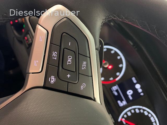

Post11-04-2022, 12:57    Subject: Retrofitting GRA for VW T-Cross Quote
Here's another photo of the steering wheel, hopefully it's helpful...
The keys would be available.

Post11-04-2022, 15:20    Subject: Retrofitting GRA for VW T-Cross Quote
I suspect that this coding cannot be performed with VCDS. It probably only works through the central server to ensure that the equipment list is correctly stored in the database, so that the coding isn't reset again during the next visit to the workshop.
