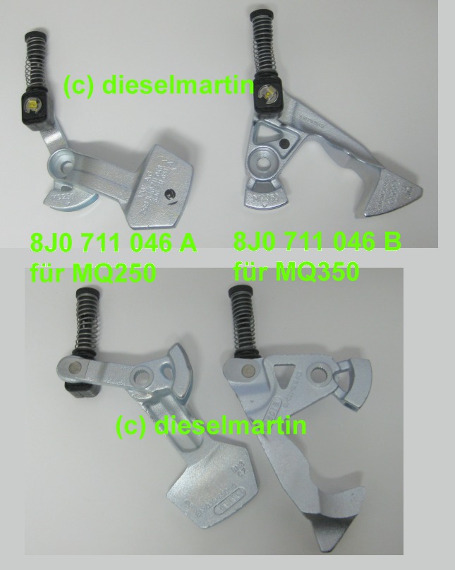

To the 1.9 TDI section, those of you who are messing around with an MQ250.
Your solution is called 8J0 711 046 A.
Translated on 27-09-2026, 5:42.
Joined: 03/13/2003
Posts: 10121
Location: in der Werkstatt
Post25-01-2011, 23:14    Subject: Gearbox Shortening: Smooth Shifting at 37k Miles Quote
Buy it.

Post26-01-2011, 12:29    Subject: Gearbox Shortening: Smooth Shifting at 37k Miles Quote
Does that also apply to a 2003 EEN?
You're welcome, haithamina.
Joined: 03/13/2003
Posts: 10121
Post26-01-2011, 12:49    Subject: Gearbox Shortening: Smooth Shifting at 37k Miles Quote
Sorry.
3Bx "Audis" do not have a seat adjustment function icon_arrow.gif and therefore do not fit.
Translated on 27-09-2026, 5:43.

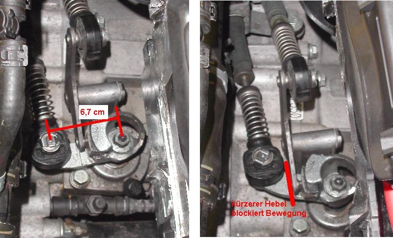

Post04-02-2011, 22:07    Subject: Gearbox Shortening: Smooth Shifting at 37k Miles Quote
dieselmartin wrote:
Does it fit?:
However, it apparently doesn't fit on all M350 models: Regarding the shift lever, the 9N and 6L models have the forward-reverse lever and the up-down block one after the other, instead of facing each other.
Even with the standard version, the forward-reverse lever is so short that the cable head, when a gear is engaged, almost touches the up-down control lever.
Therefore, implementing a SWV (Steering Wheel Vibration) would require a complete redesign of the steering column actuation system...
