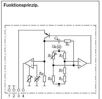

Gremlin
Guest
Post28-10-2004, 7:44    Subject: LMM Bosch Mercedes Values Quote
Funny...
In the current sensor catalog, it is not listed, but it is in the online catalog...
I suspect, based on the number (217), that it is an HFM-2.
then he really only had 12V as the supply voltage...
See you, Gremlin

Kebayer
Guest
Post02-11-2004, 12:23    Subject: LMM Bosch Mercedes Values Quote
Thank you for the information, but the occupancy figures do not match my LMM.
I have now been able to find a circuit diagram with a connection diagram and have discovered that the LMM is functioning correctly.
Greetings
