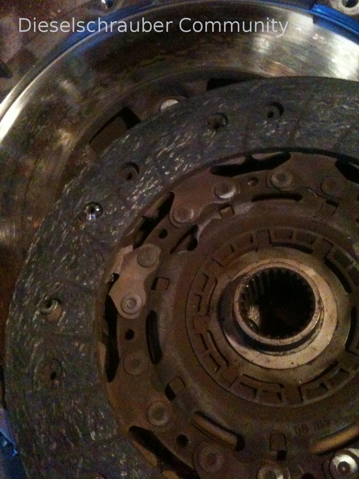

Post04-12-2015, 20:05    Subject: Re: Construction site: AXE T5 engine removal Quote
Gremlin wrote:
Disassembled, errors found...
 Sefekte Kupplungs-Reibscheibe
 File size:  1.34 MB
 Viewed:  6683 times
RedR32
Avatar-RedR32
Joined: 12/21/2008
Posts: 1071
Location: Bad Lobenstein
1998 Volkswagen Golf
Post04-12-2015, 21:09    Subject: Removing the bevel gear (type 0A5) on a VW Transporter T5 Quote
Hey, it looks like it's cracked or broken off. How many kilometers has it driven?
Best regards,
reflexsilber met.
Gremlin
Avatar-Gremlin
Joined: 08/18/2005
Posts: 396
Karma: +92 / -0   Thank you, like it!
Location: Grainet
2000 Audi A4 Avant Consumption
Post05-12-2015, 11:43    Subject: Removing the bevel gear (type 0A5) on a VW Transporter T5 Quote
Approximately 187,000 km; I'm not sure how many of those kilometers were driven by the previous owner.
In terms of bodywork, it was top-notch, even though it came from a heating and plumbing company.
And yes: The covering material has detached from the rivets, or a retaining arm has broken off.
While the dual-mass flywheel is still within acceptable limits, the friction surface is discolored blue due to the entire incident (the clutch didn't disengage properly).
Complete set, new, including pressure plate; either LUK or Sachs...
