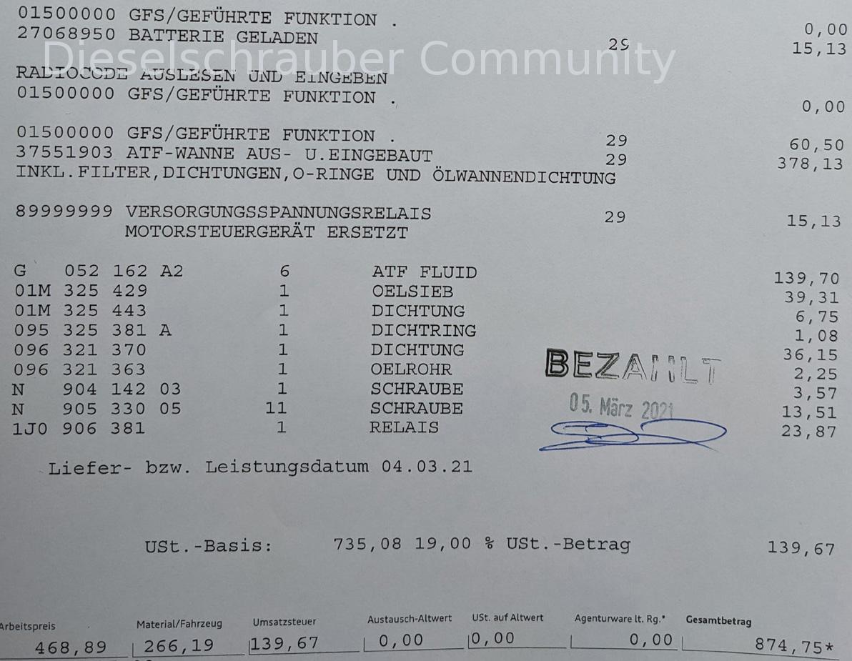

Post05-03-2021, 18:39    Subject: Automatic transmission fluid - durability in the transmission Quote
Mpire wrote:
Hello...
Based on your description of the problems, it seems like the issue might be related to the oil/oil level, the filter, and the gasket of the same component.
Greetings Mpire
Thank you very much, Mpire. You encouraged me to get the oil changed, and you predicted an excellent result, which proved to be true.
The transmission is now shifting almost perfectly again. It's like night and day!
Unfortunately, I can't do things like that anymore. I don't have a workshop anymore, and going to the car with a skateboard on the street is too dangerous for me at my age; it's just not possible.
Your suggestion about using the oil (HP5) is probably good, but of course, Audi wouldn't listen - they insisted on using the oil that is specified for this car.
Luckily, I was able to convince her to replace the rubber seal that seals the filter.
Okay, I'll think about having the transmission fluid changed again to make sure fresh oil also gets into the torque converter. It's sure to be cheaper than this time, but it's not exactly icon_smile.gif cheap.
P.S. I still need to ask why the brand new battery that I bought three days prior and had fully charged was charged again at Audi icon_smile.gif.

Post06-03-2021, 16:36    Subject: Automatic transmission fluid - durability in the transmission Quote
Hello.
I'm glad it's working again icon_wink.gif.
They (at least according to the invoice) filled it with ATF G052162A2. That's equivalent to ATF5 or HP5, everything's good, perfectly right.
Then, for once, everything runs normally in that workshop.
The three major service centers in our area (Nuremberg/Regensburg/Wackersdorf) only use the new green HP8 ink, with the corresponding consequences. icon_evil.gif
Before switching to a different oil, I would drive it for a good while, possibly change the 3 liters of oil again after 15,000 miles, and that should be good.
I think the new filter, the sealing ring, and the correct oil level probably made the biggest difference.
The switching will improve further once the controller has learned the new parameters.
Regards, Mpire.
