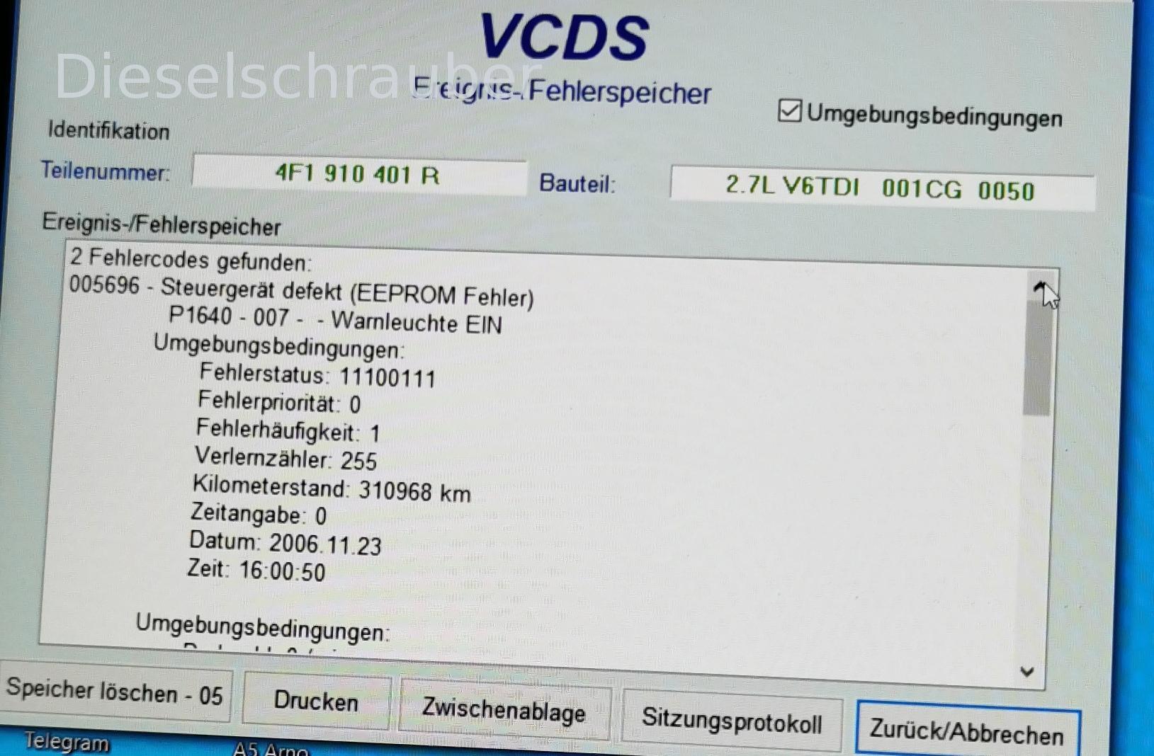

I had my engine control unit (ECU) updated by a tuner, and now I'm getting this P1640 error code every time.
What could be the cause of this?
Is there anything I need to consider during installation, or do I need to use VCDS to program it?

I will send you the Autoscan results tomorrow. I only have a Screenshot of the error at the moment.
 Fehler p1640

Post05-12-2021, 9:28    Subject: P1640 Error After Update: Troubleshooting Guide Quote
You had your engine control unit (ECU) tuned, and now it's saying it's defective.
Do you remember anything?

Why don't you go back to the "tuner" who installed the software? His diagnosis seems wrong ("ECU defective, EEPROM error"). That's a pretty fundamental issue within the ECU. VW or Audi certainly wouldn't have caused that.

Play the original file. It's a shame if the EEPROM error persists because no meaningful changes were made during the flashing process. However, there are also knowledgeable tuners who can fix this. icon_idea.gif

As far as I know, the problem you're referring to has already been fixed in the 0030 model. It affected the 0010 model, and it wasn't possible to initiate the regeneration process on that model.
What year is it?
Find someone with a VCP (Vehicle Control Panel) and try flashing an SGO or FRF (firmware).
If the error still persists after that and it's still an EDC16, then it can be repaired using a BDM file. However, if it's already an EDC17, it becomes a bit more complicated.
So, you initially had a problem with the DPF, not the software, but now you have both.
