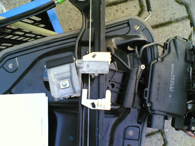

Hi.
While working on the door panels in my Leon, I just broke a window regulator bracket (see picture, the white part used to be one piece).
And now?
New eFH?

First of all, my condolences!
The Golf IV also always had problems with the window regulators because something would break off. There were repair kits for that. However, as a Passat driver, I don't know if it's exactly the same part. There must be someone here who can confirm or deny that.
You can start by searching online or in other sources for a repair kit; that might help you for now.
Best regards!

Are the sliding pieces available individually? (I couldn't find them.)
Does anyone have the part number?
Or should it be the replacement part?
Translated on 09-09-2026, 16:50.

Based on my experience with G3, I suspect your experience will be similar:
With the G3, they are only available as replacement parts. I tried them out briefly, but re-winding the cables properly is no fun. I think they cost around 70 euros. However, a different plastic part always breaks off, the part that holds the cable jacket in place.

Post25-09-2006, 10:16    Subject: Broken Window Regulator: What to Do? Quote
I took that part out yesterday.
It doesn't seem too difficult to get the ropes back onto the reels.
I actually just need a white sliding piece where the ropes can be hooked.
Audi has a part with the number 4B0 837 463.
Is this what you're looking for?

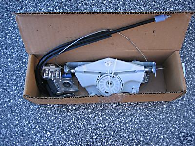

Post25-09-2006, 12:24    Subject: Broken Window Regulator: What to Do? Quote
News:
VW: Golf 4 repair kit, EUR 35, includes cables with housings and a "drum," 2 sliding pieces.
The sliding pieces are now made in one piece (cast) and have a plastic sliding surface.
I think these fit the Leon, but PartsMan says "no, they don't fit."
Seat: No replacement part available. Complete window regulator (including rails) is new and costs EUR 57.
I then need to rivet the rails onto the device carriers.
Tonight, I'll get the Leon ready to drive and go to VW with the device carrier. If the sliding pieces can be clipped onto the rails, I'll take the repair kit.

Here are the new GUSSTEILE included in the complete repair kit.

Post25-09-2006, 18:30    Subject: Broken Window Regulator: What to Do? Quote
The G4 replacement part does NOT fit.

AAAAAAAAAAAAAAAAMOK
After drilling out the old brackets (which were attached to the supports with 4 rivets), I wanted to attach the new ones.
Forget about it - standard (DIY) pliers can only handle a maximum of 3.0mm pins for 5mm rivets. However, Seat manufactures 3.2mm pins for use with 5mm rivets.
So, I'm going to Seat again today to have them rivet the rails onto the carrier.
It has the advantage that I will also become known there soon icon_rolleyes.gif.
Translated on 09-09-2026, 16:56.
