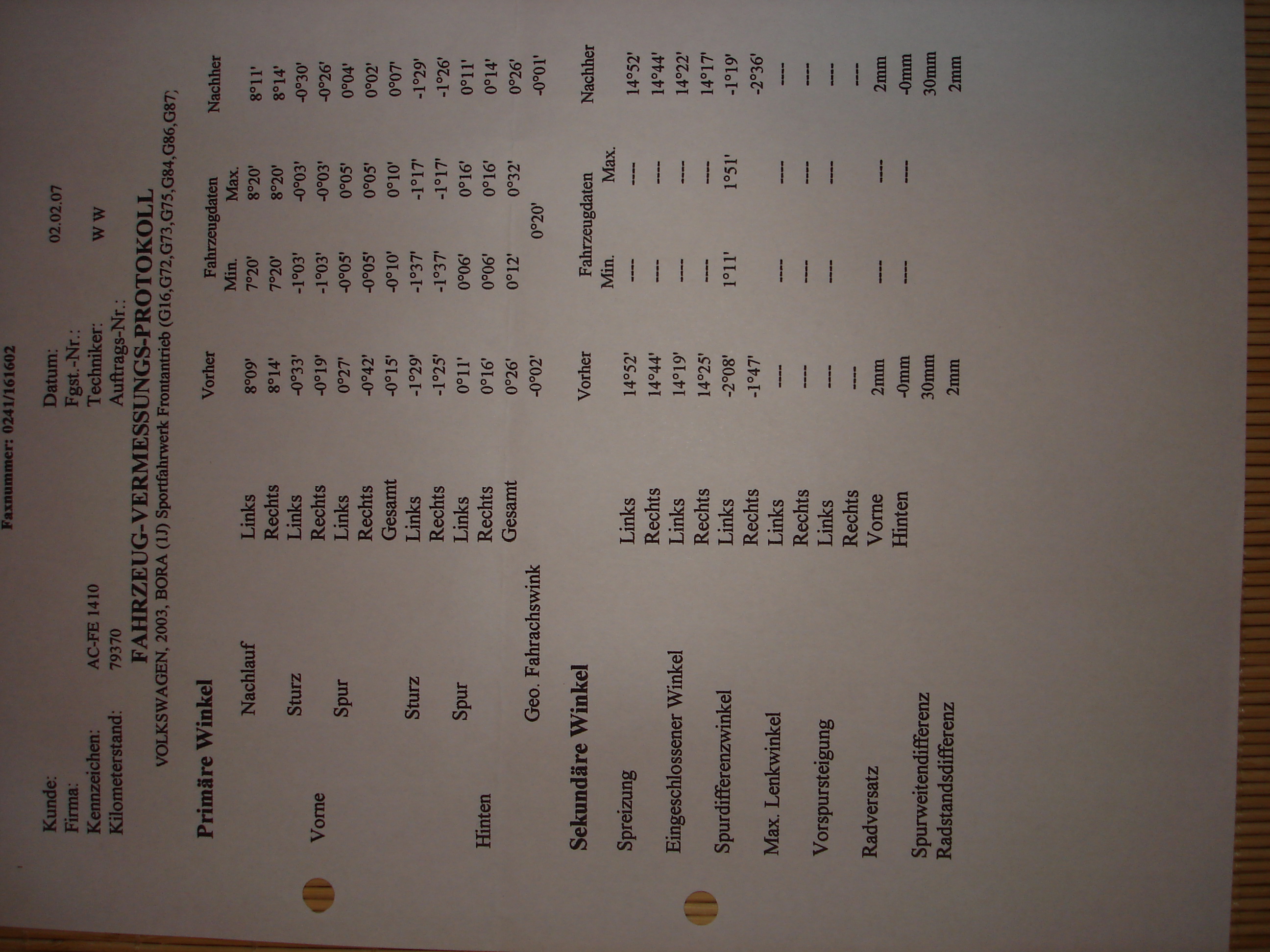

Ferdi
Guest
Post01-11-2008, 0:40    Subject: Passat Variant 3BG Rear axle failure Quote
My Passat also had edge wear on the rear, both sides, and on the outer edges, as well as saw-tooth formation.
Since I've owned the vehicle, all the wheels have been running perfectly evenly, without any changes to the vehicle itself.
Sometimes (if only the outer edges are affected), it's simply a matter of the driving profile, even though some people may not agree with this
I am, after all, critical, could you give me a tip on how I can change my driving style in this regard so that the outer flanks are not abraded and do not tend to form saw-tooth patterns!
Values are important to me, I cherish them! But they look good, and most importantly, I can't identify any negative aspects in the driving behavior!
My driving profile consists of 80% highway, 15% rural roads, and 5% city driving over a 100 km distance, both ways, while I consciously drive in a fuel-efficient manner! I don't encounter hairpin turns on my commute! Maybe just the AB exit, which I quickly pass through so that I can still have momentum when I enter the roundabout!
This is also the only situation where I could imagine increased wear on the outer side of the tire, but I really don't believe it!
Could it possibly be the tires?
I fitted the Hankook Ventus Prime K105 in size 205/55-16V OE on my VW Golf.
Best regards,
Ferdi

Post01-11-2008, 13:13    Subject: Passat Variant 3BG Rear axle failure Quote
Driving at high speeds through sharp turns, making sharp turns with momentum, and accelerating/decelerating simultaneously (or performing "aggressive" overtaking maneuvers) are all factors that increase the risk of accidents. To make the rear of a Passat "drift" so that it runs off the edge of the road, a very skilled driving style with ESP disabled is required.
However, based on your description, I do not assume such driving patterns, and would leave further measures to the specialist after axle measurement as part of the diagnosis and, if necessary, adjustment. I am not familiar with the rear axle construction, and therefore I have no idea which parts were bent or distorted due to the impact against the curb edge, or what extent of corrective measures can be taken.
Some of our service vehicles also wear down the tires on the outer edge. However, this is only due to the tires on the front axle. This is likely due to almost exclusively city driving and the high axle weight on the front axle. When making sharp turns, the Passat noticeably pushes the front wheels. The tires are 205/16" Bridgestone steel wheels. Continental winter tires in the same size have more grip, but also wear down faster on the outer edges over time.
In addition to the axle-based tire change, our own workshop regularly removes the tires and continues to use them on the other side of the vehicle, while maintaining the same direction of rotation. Therefore, they are at least evenly used up when the profile depth has reached the minimum threshold.
Golf 4 and 5, as well as (to a lesser extent) the T5, also share the same engine characteristics. Specifically, I would have expected more wear and tear due to the higher vehicle weights in combination with the high center of gravity, compared to the Golf and Passat.
