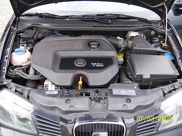

Perhaps not based on the physical dimensions, but could someone post a picture of the engine bay from the 160 hp version? ULF, how about you? We have one with the ATD engine, let's see if we can spot any differences.
Thank you.

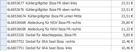

I can even look up the prices for you, at least the prices from the order our client placed, see the attachment.
The price includes approximately €210 for the bumper itself. The mounting points are the same, so it's a perfect fit, as are the headlight adjustment nozzles. Only the covers are different, so new ones are included.
The prices listed in this document are valid as of May 2009.
I've also attached some more detailed pictures of the top and bottom grilles.

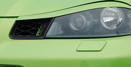

Well, the redesigned front end actually looks okay aesthetically – especially if you add the FR honeycomb grille.
"What would certainly be possible is to install universal spray nozzles or universal nozzles that are only located in the bumper. However, the appearance wouldn't be ideal."
"And if you switch from hub cylinder nozzles to regular nozzles, you need a pressure distributor/shut-off valve, otherwise the container will empty."
If you're planning something like that, let me know, and I'll find the contact information for the distributor. All VAG cars with standard nozzle injectors have them, like our Octavia 1 icon_smile.gif.

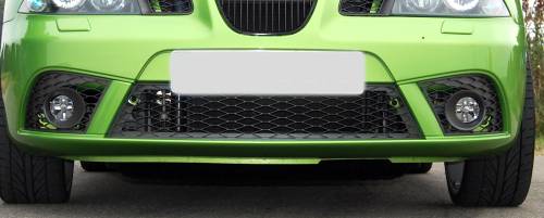

Here are a few words about assembly:
* 99% works without any modifications.
* Front before facelift: There are foam pads glued to the mounting bracket where the bumper rests, but they are very small and only at the corners, and they don't fit properly anymore... you have to remove them first, otherwise you'll be struggling with the front bumper for ages.
* The old SRA hub nozzles still fit, but the covers that are screwed onto the bumper no longer do, so I've included them in my list.
* The rear fits perfectly without any issues.
"When ordering parts for the front grille, etc., it's a good idea to also order the small screws, as your SEAT dealer will likely see in the AKTE system that the old ones are often corroded."
* For the upper part of the radiator grille, you should reorder the two rivets that secure the middle grille, as they are likely to be broken in 90% of cases.
"If anything is unclear, feel free to ask. I've been through all of this before."

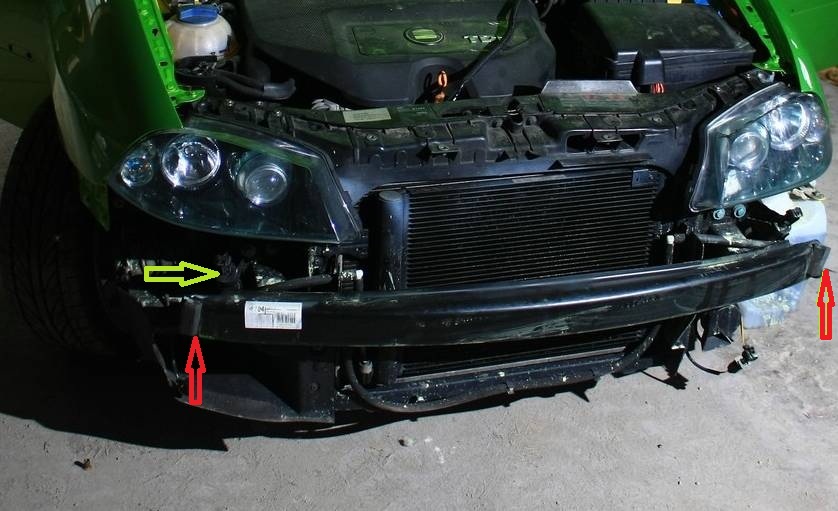

Because it was asked, and Ulf is too lazy icon_wink.gif to remove his front bumper, here's a picture of the FMIC (Front Mount Intercooler) of the Cupra.
http://www.pictureupload.de/originals/59546/161009002940_sonstige_ibiza_cupra_llk.jpg
Translated on 09-09-2026, 18:47.
Octavia_4x4
Joined: 04/06/2008
Posts: 2720
Post16-10-2009, 10:15    Subject: Xenon Headlights Ibiza 6L (Non-Cupra) Quote
Okay, now I can see it in person... In my opinion, the problem is the upper intercooler pipe, which is severely obstructing the injector.
See the attached image. The green line indicates the nozzle, which is in the way.
@RedR32Viewing profile: RedR32: I've marked the buffers mentioned above with red arrows... you need to remove them from the bumper, otherwise you'll spend hours trying to figure out why the facelift front bumper doesn't fit.
