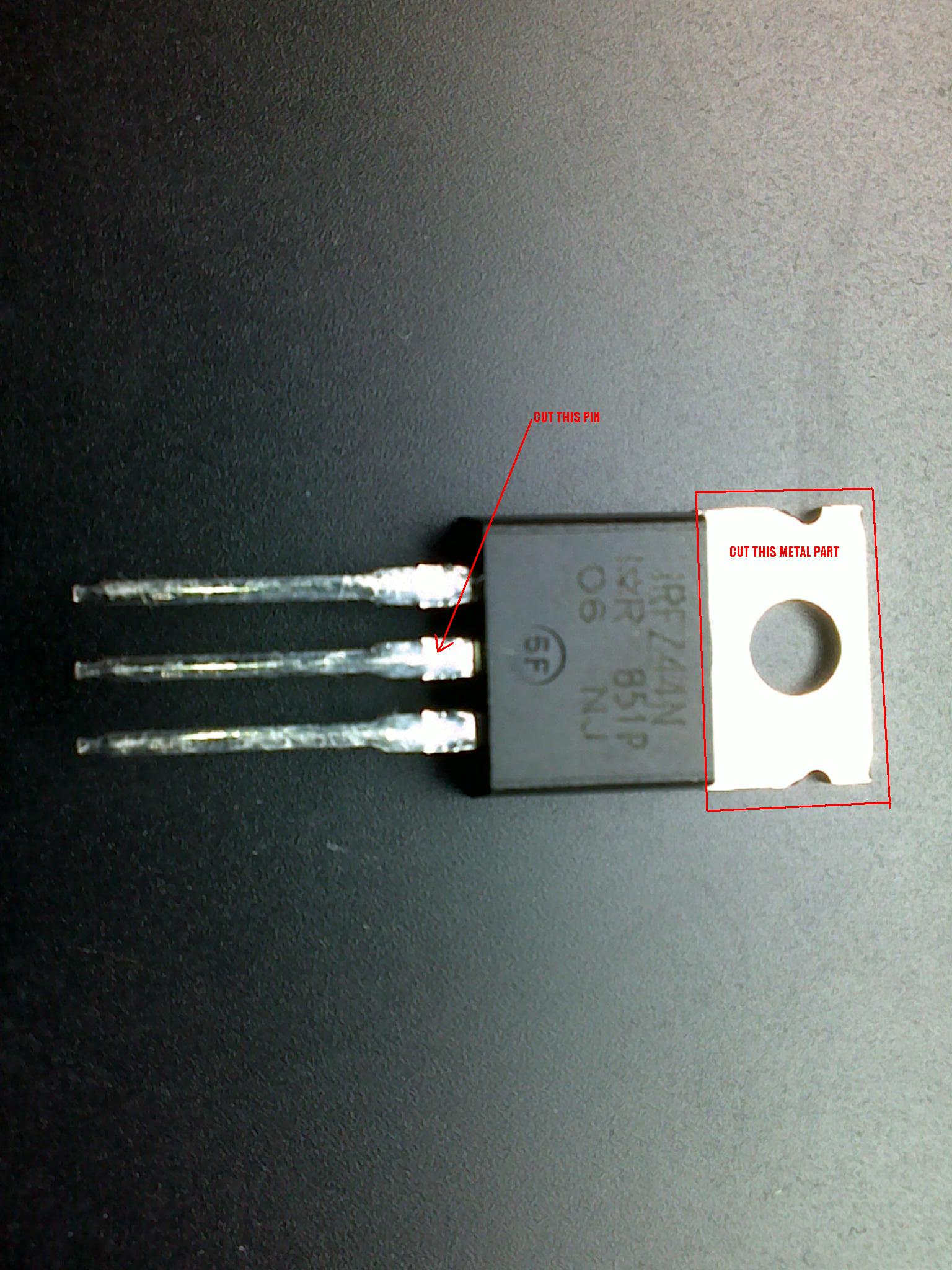

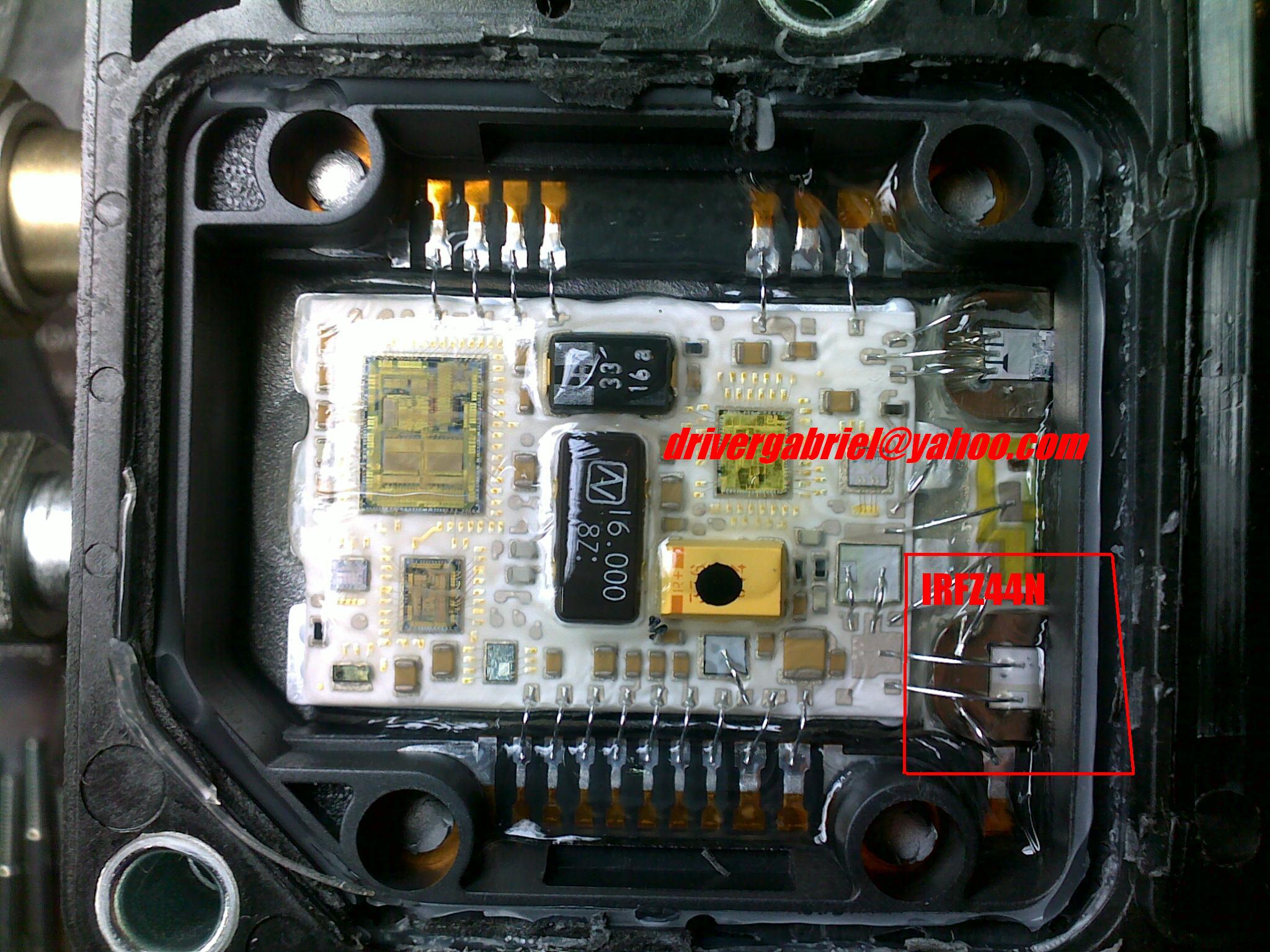

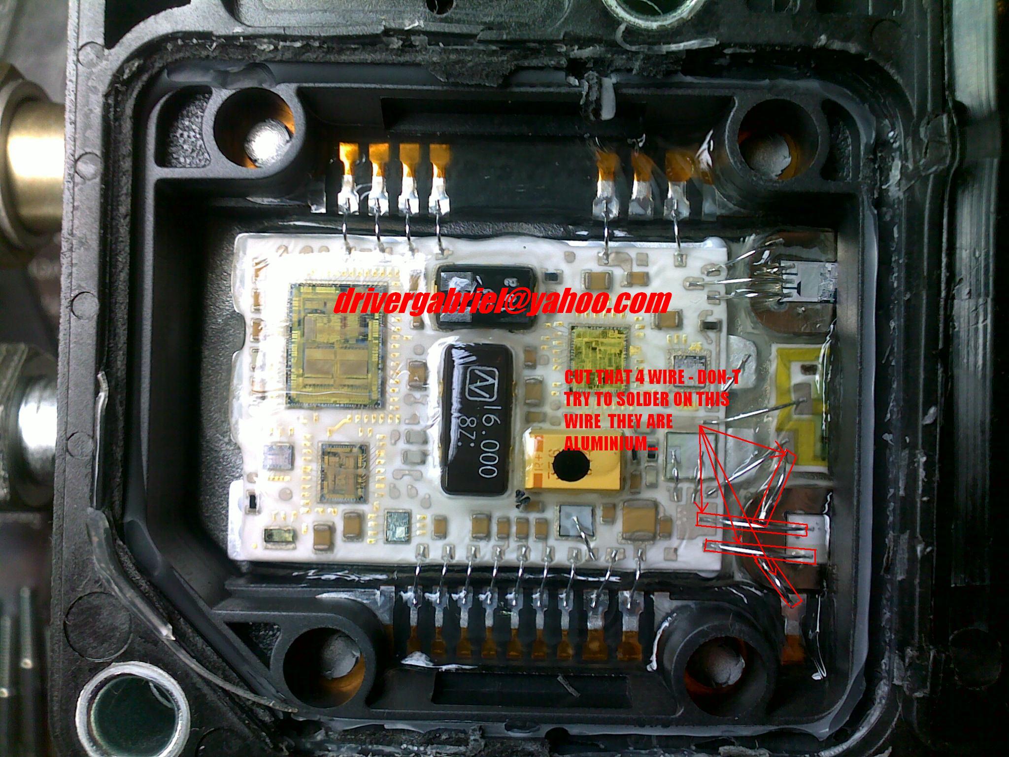

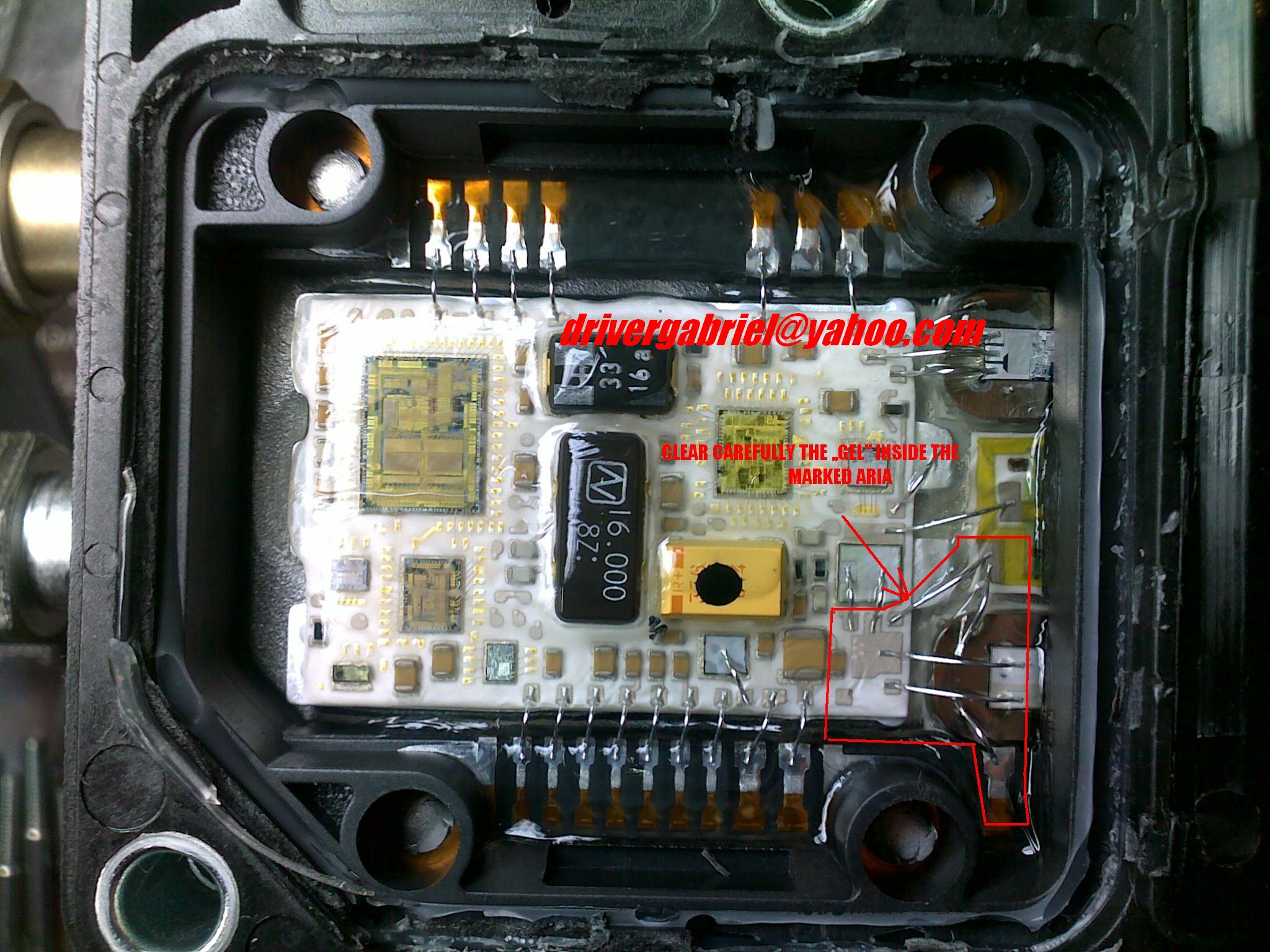

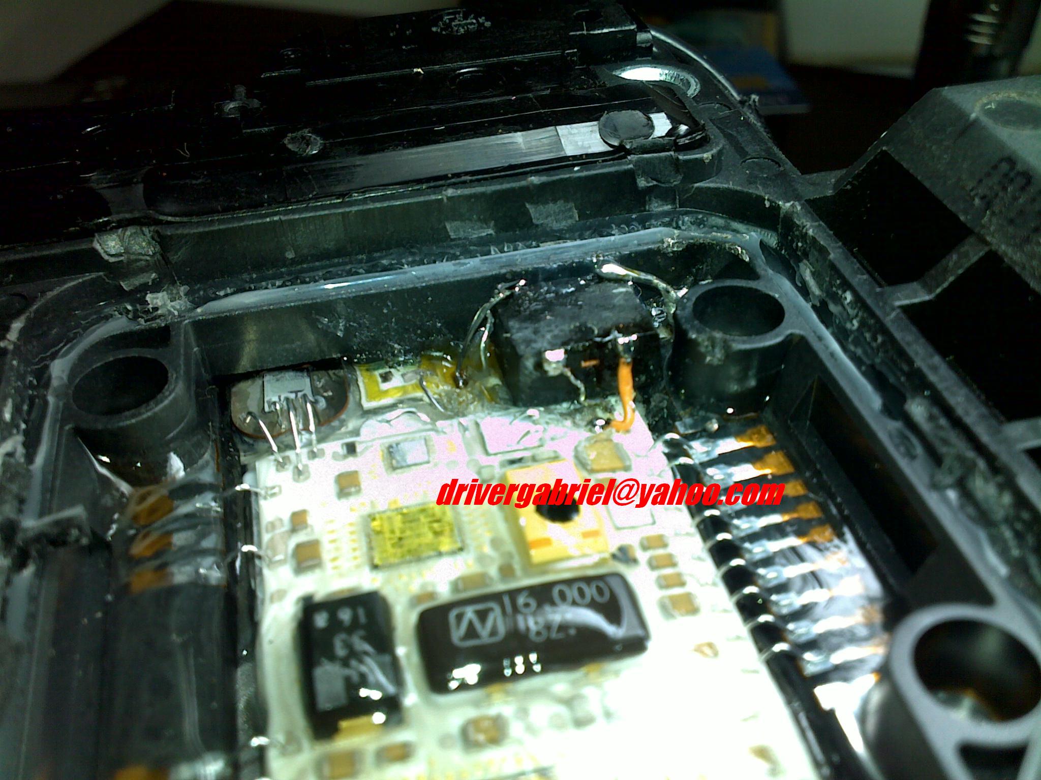

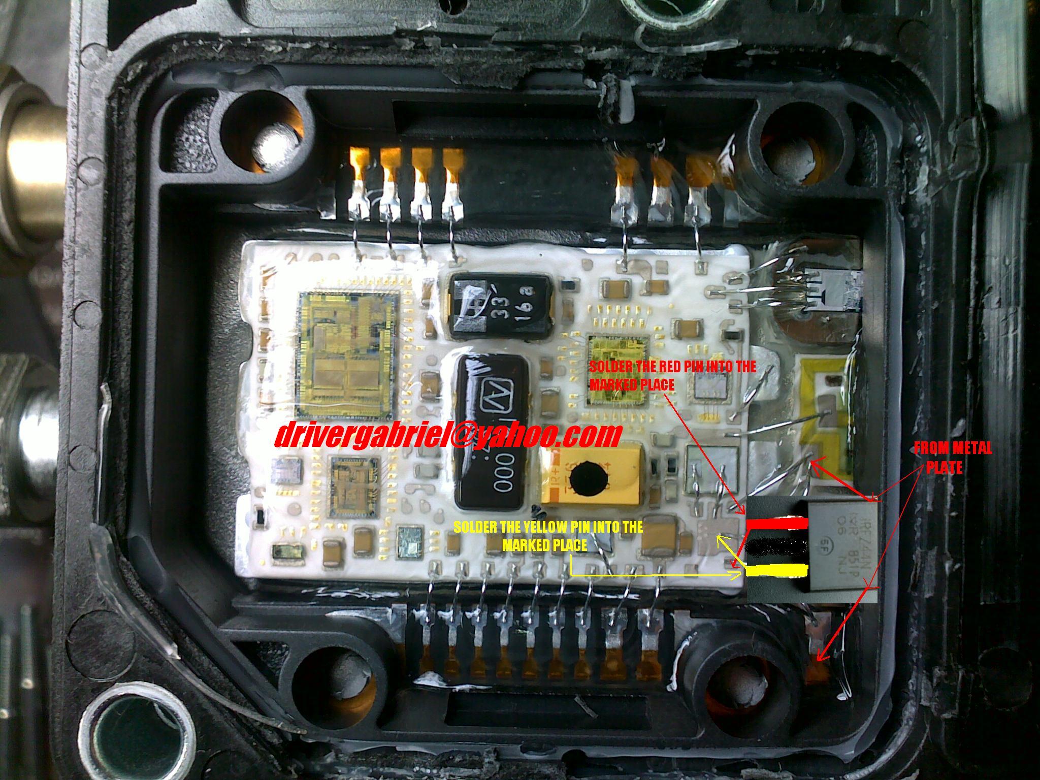

Although the method looks very un-German, it works perfectly when grilling the FET. The problem is, as also shown in the pictures, that the wires are made of aluminum, so you can forget about soldering. You'll have to use the pads that are marked as red areas in the picture. Are you also interested in the diagnostic tool? This is not a tool in the sense that it reads out VAG error codes, but directly displays pump parameters.
I'm going to create a list of things I can retrieve and post it here.
