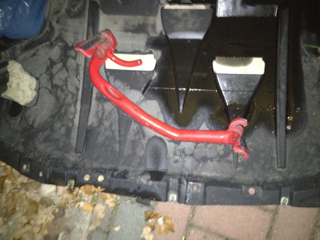

On Saturday, a friendly truck, car, or van transporter lost one of these wheel clamps (http://www.asb-logistic.de/uploads/pics/pkw_transporter.jpg those red things). Unfortunately, I didn't have a chance to swerve and could only get between the wheels.

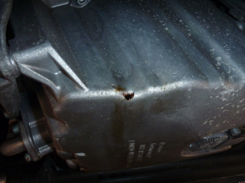

Now I have a small hole in the oil pan, and I'm losing about 100ml of oil overnight.
Is it possible to repair something like this while it's installed, or does the entire tub need to be removed and replaced?
The oil pan is made of aluminum/magnesium.

Post07-11-2011, 8:59    Subject: Should I replace or weld the oil pan on my Audi A4 B7 2.0 TFSI? Quote
in my humble opinion, new. Even if the material can be welded, you can't do it with the reservoir on the engine, with the oil vapor/film inside.

Post07-11-2011, 9:38    Subject: Should I replace or weld the oil pan on my Audi A4 B7 2.0 TFSI? Quote
Not possible in the attached state. Cast iron must be preheated before welding, otherwise it will crack again within two days.

Post07-11-2011, 12:51    Subject: Should I replace or weld the oil pan on my Audi A4 B7 2.0 TFSI? Quote
Steel oil pans can be welded (after being disassembled) and properly cleaned. Cast iron or aluminum can also be welded, provided you have the right equipment and people who know how to use it. However, the question of cost-effectiveness always arises. In any case, disassembly and reassembly are necessary, which means a new seal is always required. The decision is usually easier when you compare the price of the replacement part to the cost of the repair. The invoice may already look quite clear, especially if you have to have the oil pan repaired.

Post07-11-2011, 18:07    Subject: Should I replace or weld the oil pan on my Audi A4 B7 2.0 TFSI? Quote
I think his main concern was whether the bathtub could be repaired while it was installed.
Unfortunately, with the A4 B7, the front axle either needs to be completely removed or lowered using special tools in order to remove the underbody panel. He definitely wanted to avoid doing that work.
But I can only confirm that it doesn't work.
I once tried to weld a crack in the oil pan of my Golf. It's hard to get a good seal.
Needs to be renovated and cleaned.

Post07-11-2011, 18:55    Subject: Should I replace or weld the oil pan on my Audi A4 B7 2.0 TFSI? Quote
Voodoo perfectly captured what I was trying to convey.
Well, the car is now at the VW/Audi dealership... I still have the extended warranty and I don't want them to make a big deal out of it because of some "botched" repair.
The bathtub costs 90 euros without tax, so it's brand new.
I'm attaching the pictures. Looking at the main structure, you can get a sense that things could have been much worse.
 Opfer, Audi A4 B7 2.0 TFSI Ölwanne

 Übeltäter
 File size:  274.03 KB
 Viewed:  5518 times

Hey! If this thing gets caught in a rut on the road and starts spinning, it could even shatter a windshield. Did you get lucky? icon_eek.gif

Yes, that's also my personal conclusion and my comfort. I don't think I did anything wrong in that situation, and I believe I reacted correctly by trying to steer the car directly into the object rather than attempting an evasive maneuver.
Perhaps less would have happened if I hadn't braked, and it might have just slid under the car... but on the other hand, it could have also shot up into my rear end or something.
I initially thought it was just a stick because it was under a bridge, and it appeared black to me at first.

Post08-11-2011, 21:51    Subject: Should I replace or weld the oil pan on my Audi A4 B7 2.0 TFSI? Quote
The "correct" repair is to replace it.
If it were clean on the inside, it would definitely be possible to weld it while it's still installed. You just need to find someone who can do it and who will make sure that the particle in the oil pan is removed.

Post09-11-2011, 12:58    Subject: Should I replace or weld the oil pan on my Audi A4 B7 2.0 TFSI? Quote
BM wrote:
The "correct" repair is to replace.
Exactly that is happening now.
Unfortunately, the price is quite high (VW charges 550 euros, while my trusted independent mechanic would do it for 300), but since the car has a relatively high oil consumption even without a hole in the oil pan, I don't want to risk any warranty or goodwill issues.
I was supposed to have an oil consumption test scheduled for Monday, but now I'm having the oil changed to Mobil1 0W40 and I hope that I can increase the mileage between oil changes from 1000km to 5000km.
