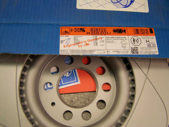

The ATE brake discs, size 312, for this car are also coated. Both the "Power Disc" shown in the picture and the standard version without the groove are coated.
 ATE PowerDisc BREMSSCHEIBEN 312mm
Audi: A3, TT
VW: Bora, Golf, NEW, Passat, Vento
Seat: Ibiza, Leon, Toledo
Skoda: Octavia
 File size:  28.92 KB
 Viewed:  12010 times
Passat Variant BGW 2005
Translated on 03-09-2026, 20:51.
