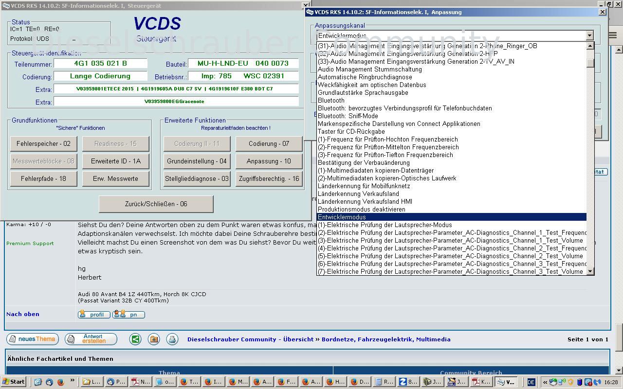

Perhaps you should take a Screenshot of what you're seeing before proceeding, so that the entire system doesn't crash. The descriptions on other websites can sometimes be quite cryptic.

Thank you for your reply, and don't worry, you're not questioning my mechanical skills; I'm just not a professional, and if what I read doesn't match what I see on the vehicle, I ask questions. And until I know exactly what I'm doing, I won't be messing around with any control units.
I've attached the requested Screenshot here, and the "Developer Mode" entry is number 50 in the dropdown menu, which contains several hundred entries. You can see what I meant in my first post; there are no more numbered customization options available.
