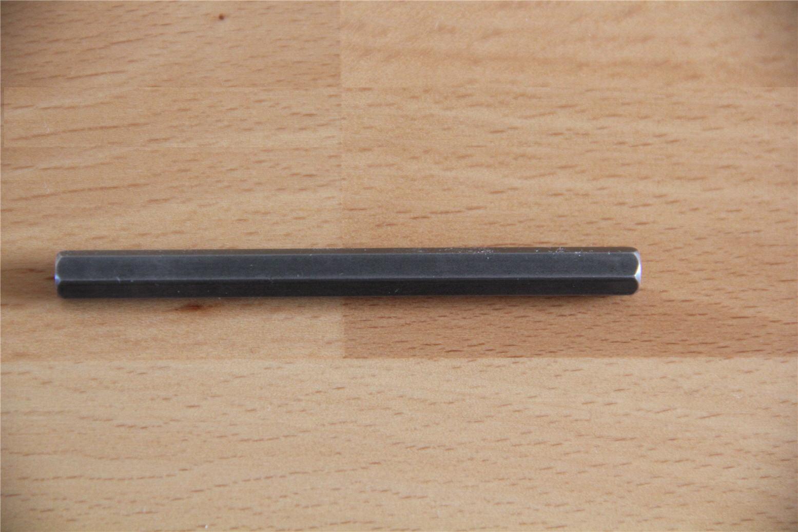

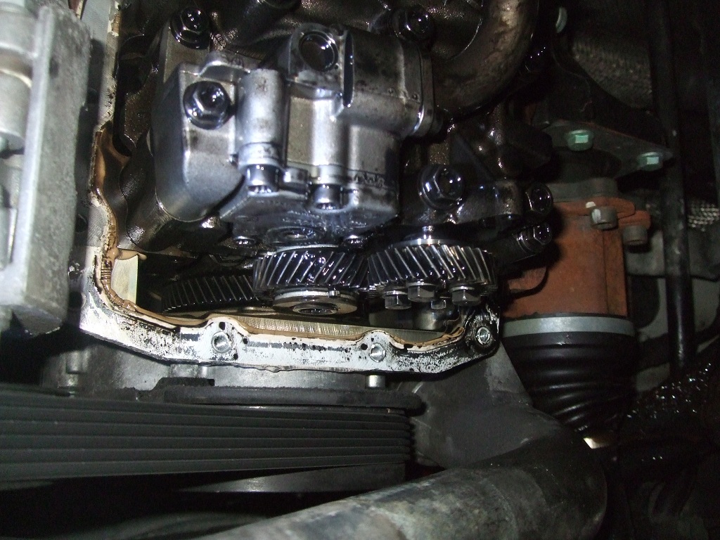

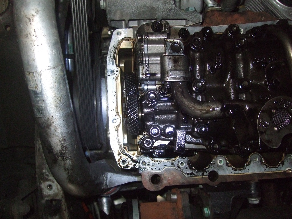

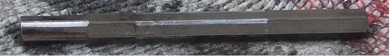

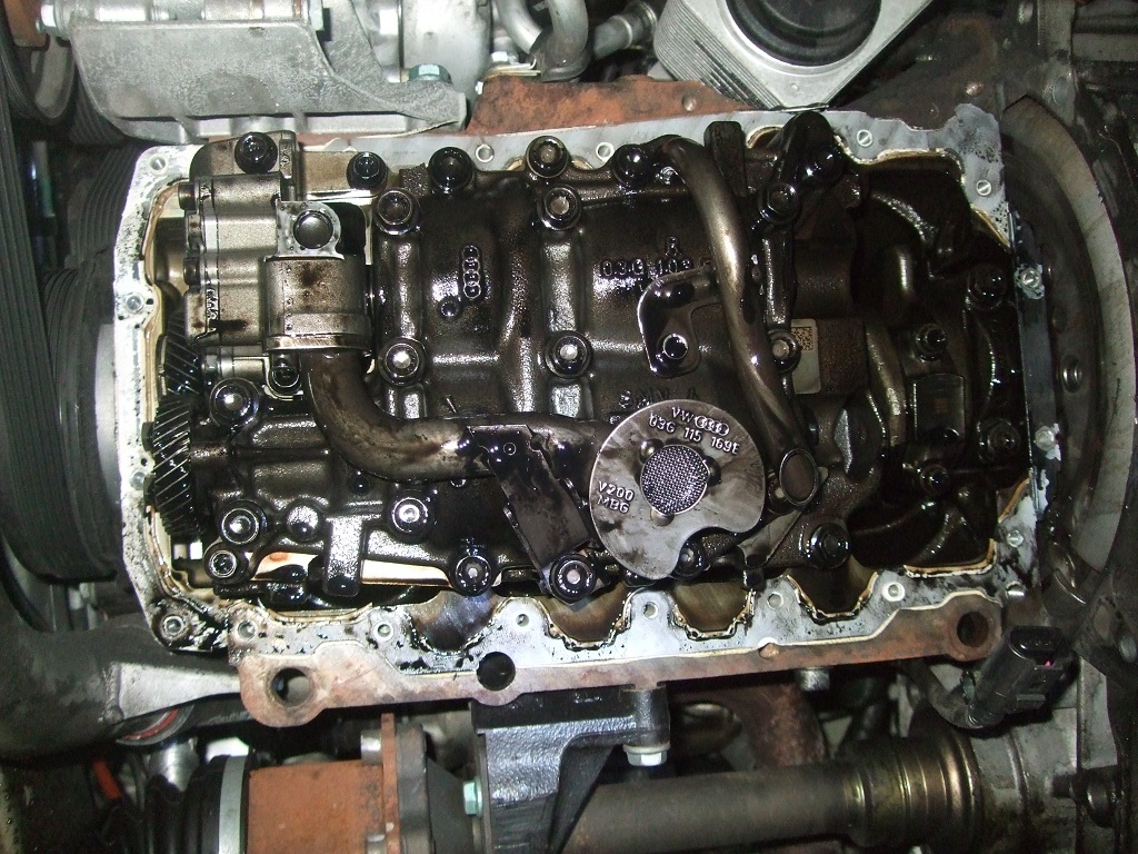

Okay, I've taken everything apart now. (That last screw on the oil pan was really stuck...)
The gears look fine, and the rest seems to be okay as well.
While disassembling the oil pump, I noticed that the shaft was partially deformed.
The question now is whether simply replacing the wave will be enough, or if we should assume that the oil pump is also broken.
I've also attached the images you requested. If anything else is needed, just let me know.

voodoo
Guest
Post05-10-2011, 20:26    Subject: TDI Oil Pressure Issue: Sharan 140PS Quote
The hexagonal item is available for purchase individually.
Unfortunately, I fear that this will only provide a short-term solution.
Because the hexagonal structure can be damaged if there are game pieces present.
And your hexagon doesn't just look bad, it looks really terrible.
Therefore, the new hexagon will soon be a thing of the past.
Since the underbody panel on the Touran is relatively easy to remove, I would be willing to take that risk.
If the new hexagon shape fails again, you can still purchase a new balancer module.

voodoo
Guest
Post05-10-2011, 21:46    Subject: TDI Oil Pressure Issue: Sharan 140PS Quote
The wave should not be round anywhere. Your wave looks very, very bad.
It shouldn't matter how you install them.
Here's what it looks like now:
P.S. The waves are rotating on the common-mode side.
Unfortunately, the new pump didn't resolve the issue.
The entire module costs over €1000.
In the large auction house, there are sellers who claim to repair the module, but whether this is actually true is questionable.
Another option would be to simply weld the hexagonal shape onto the balancer side.
Then absolutely nothing will spin anymore.
