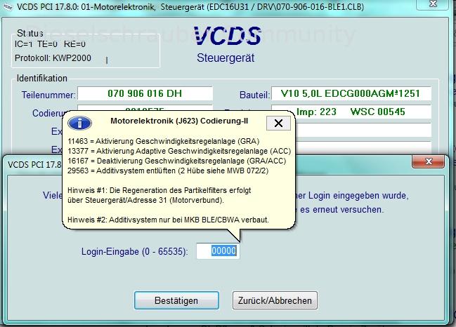

Post24-10-2017, 6:47    Subject: Access Denied: Motor Electric System (31) Quote
Good morning.
Now, the V10 (BLE) engine is installed, and it has two engine control units. Both control units indicate that the regeneration of the particulate filter must be performed through control unit 31, which is part of the engine electrical system.
However, in the engine electronics control unit 31, I do not have the necessary permissions to initiate the regeneration process.
What is the access code for that?
 File size:  156.57 KB
 Viewed:  16041 times
Arbeite mit AUTEL, LAUNCH X431 PADII, VCDS, und Stardiagnose
Fahre einen Audi A4 B8 mit 3.0 TDI Motor (Motorcode CAPA)
Translated on 05-10-2026, 6:20.

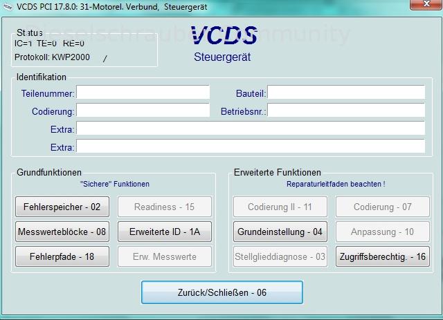

2008 Audi A4 Avant Consumption
Post24-10-2017, 7:21    Subject: Access Denied: Motor Electric System (31) Quote
Here's how it looks in the 31 Motorelektrik system. I've noticed that the part number, etc., isn't being read. Could this be the reason? And if so, why isn't it working?
 File size:  125.02 KB
 Viewed:  1530 times
Translated on 05-10-2026, 6:21.

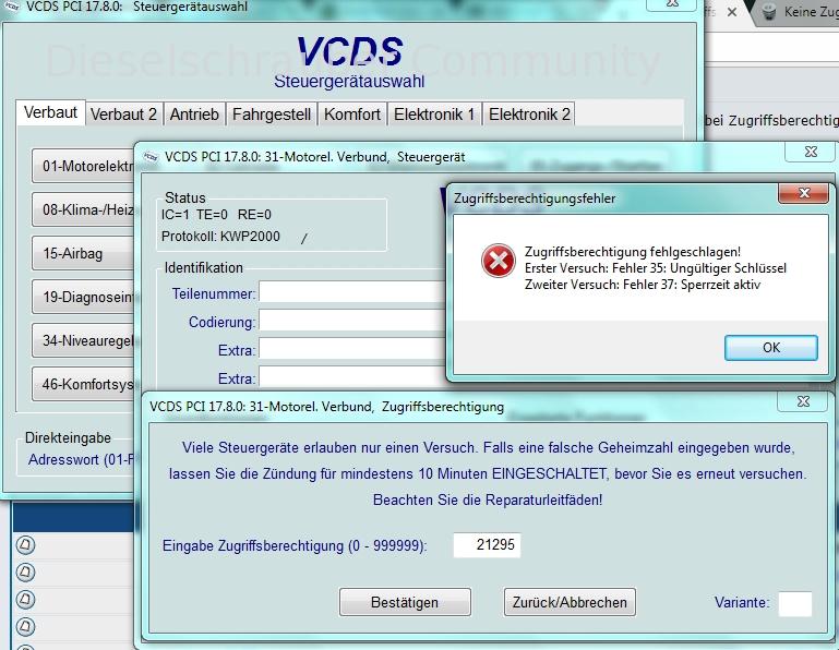

dieseltech.ch
Joined: 10/04/2017
Posts: 13
Location: Algetshausen
Post24-10-2017, 8:47    Subject: Access Denied: Motor Electric System (31) Quote
Access denied.
 File size:  222.79 KB
 Viewed:  2183 times
Translated on 05-10-2026, 6:22.

Posts: 18138
Post25-10-2017, 18:15    Subject: Access Denied: Motor Electric System (31) Quote
The following is suggested/provided for your information:
1. Check whether the GRA (cruise control) function can be activated/deactivated individually in control units 01 and 11 to verify that the login function is working correctly in those control units.
2. It is unusual for the fields in the control unit information to be empty when the control unit address is 31... perhaps the "Coding-II" button should also be active there.
3. Please attempt to use the login code "21295" in the second ECU (control unit address 11) and report whether it is accepted.
