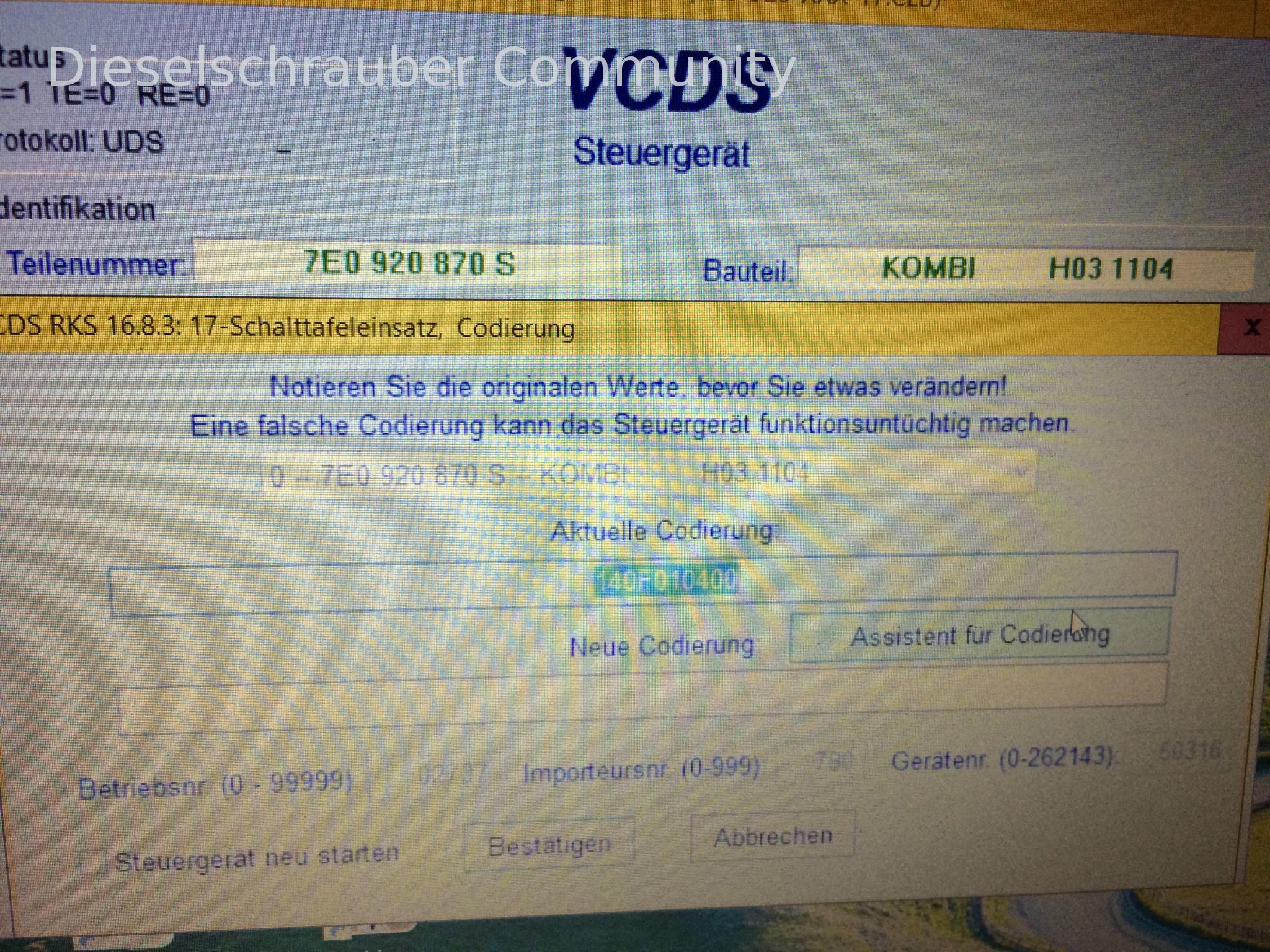

Hello everyone, how can I access the "Assi" function for long coding within address 17? Clicking on it doesn't work for me; am I doing something wrong? Thank you in advance for your answers.
- Wolfgang

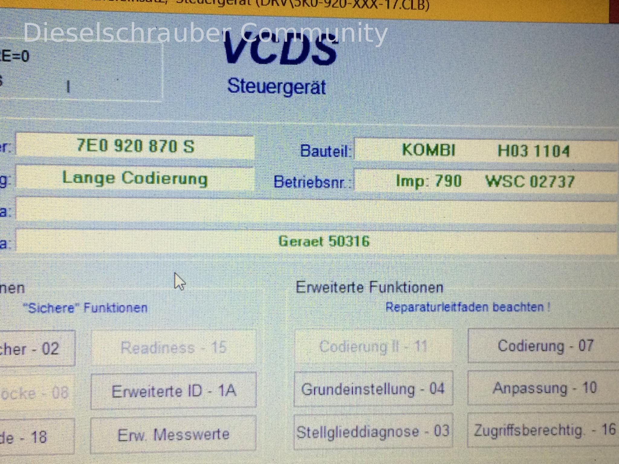

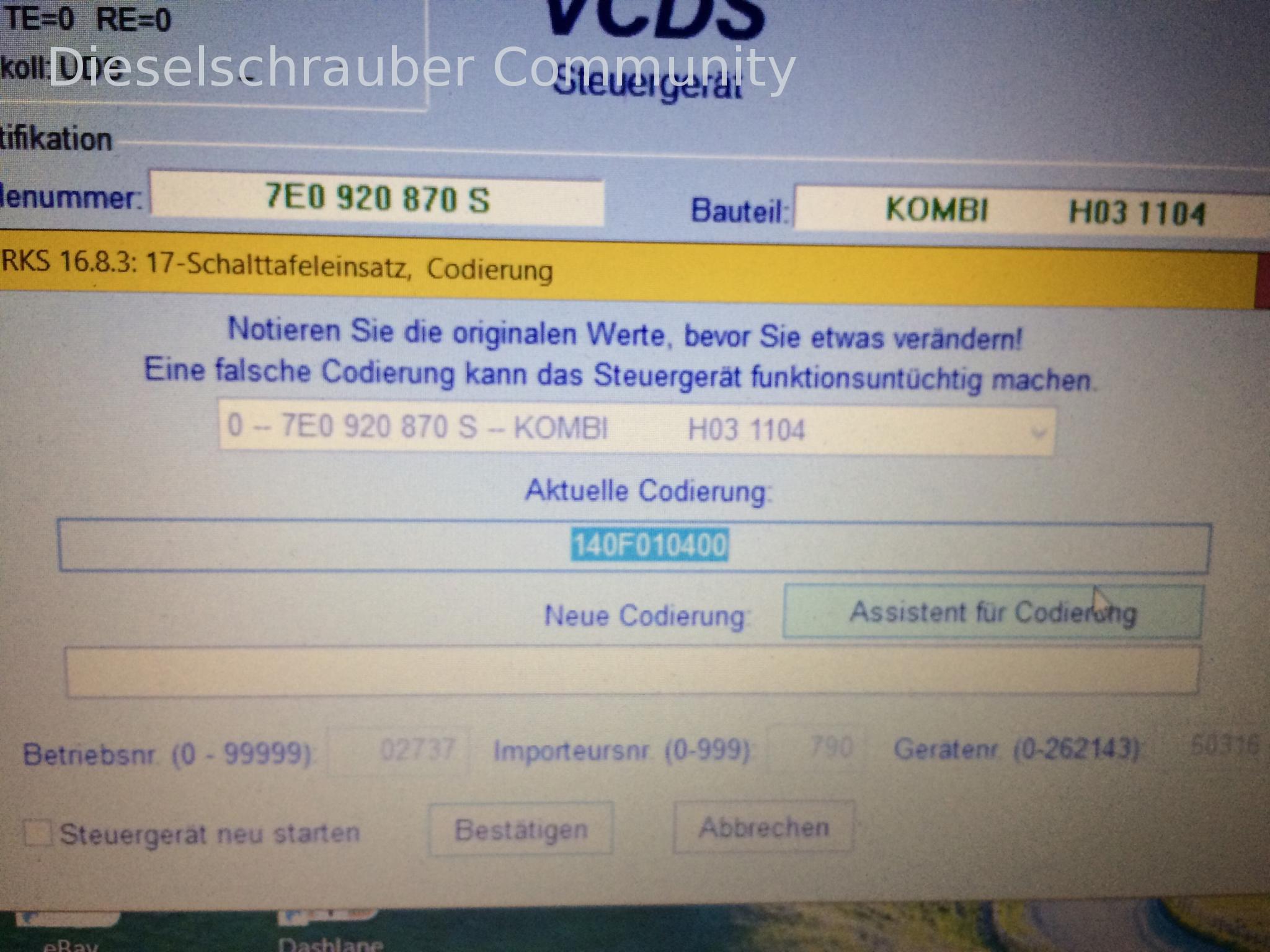

Post09-01-2017, 23:00    Subject: VW T6 Seatbelt Warning: Disable with VCDS Quote
I took two pictures with my phone; I haven't taken a Screenshot yet. The first picture shows "Stg 17," and the second picture shows "07 Codierung."

Post09-01-2017, 23:06    Subject: VW T6 Seatbelt Warning: Disable with VCDS Quote
Hello, it didn't work out very well. The first two images have a "07" code, while the third image has an "STG 17" long code. I still have a lot to learn. Thanks, Wolfgang.

Post09-01-2017, 23:12    Subject: VW T6 Seatbelt Warning: Disable with VCDS Quote
Okay, and what happens when you click the "Coding Assistant" button?

Posts: 18113
Post10-01-2017, 0:34    Subject: VW T6 Seatbelt Warning: Disable with VCDS Quote
Schmierpfote wrote:
Sorry, I didn't dare to do that. new_tomato.gif I have to drive through Thuringia again tomorrow. If I click on it, will it eventually display a "seatbelt warning" and remove the checkmark? Tomorrow after work, I will try it out. Thank you for your help, Wolfgang.
As long as you don't save the new encoding, nothing can go wrong with the encoding assistant. icon_idea.gif
